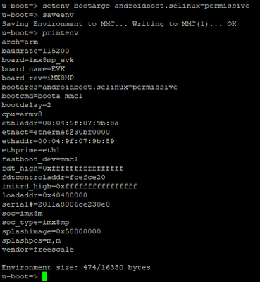

dhirajtarole
Hi @jimmychan ,
As i am working along with @rohit_alate , i have given setenv bootargs androidboot.selinux=permissive command in uboot terminal and save the environment as well.
after that when i executed boot command than board will go in infinite loop with some errors.
please find attached environment for ref,
i booted the image from the eMMC mode.
Thanks and regards,
Dhiraj

jimmychan
Please read the Chapter 6.2.1 in Android user's guide about the bootargs settings.
There is an example in page 39 about setting with boota.

dhirajtarole
Hi @jimmychan ,
I have tried this one but the board get stucked in boot  loop. this is what i have treid :-
before modification :-
uboot - setenv bootargs androidboot.selinux=permissive
uboot - saveenv
uboot - setenv bootcmd "bootmcu && boota "
uboot -saveenv
also please check the below image showing cannot find can0
