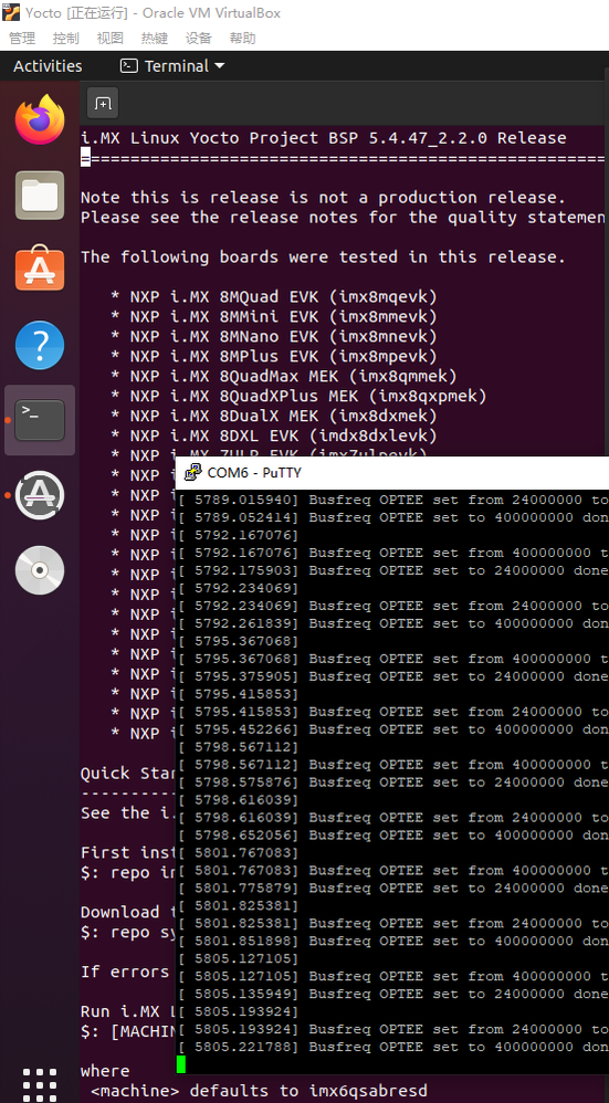

layleon
There is a lot of this information that will always be displayed periodically, why? How to mute it? Can I only modify the source code without printk?
[  206.247131] Busfreq OPTEE set from 400000000 to 24000000 start...
[  206.255946] Busfreq OPTEE set to 24000000 done! cpu=0

2,926件の閲覧回数
igorpadykov
one can look at sect.2.5.4 Dynamic Bus Frequency  i.MX Linux Reference Manual​
so if voltages are fixed, busfreq driver may be disabled. Depending on processor load voltages may
vary as "fsl,soc-operating-points" show in dts
https://source.codeaurora.org/external/imx/linux-imx/tree/arch/arm/boot/dts/imx6ull.dtsi?h=imx_5.4.4...
igor

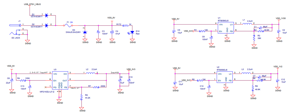

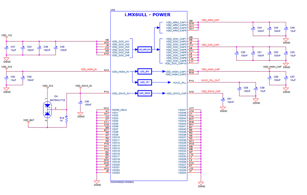

2,935件の閲覧回数
layleon
fixed 3V3/1V2/1V35 by DC-DC converter
The same DDR P/N, 128MB NAND, has been booted and the DDR has been calibrated.
Reading the code, it looks like the DDR frequency keeps changing(periodicity) from 24MHz to 400MHz(400MHz to 24MHz), which triggers this change, why is this? This output is very disturbing to debug ah.
2,927件の閲覧回数
igorpadykov
igor
