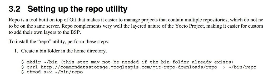

    But i do the step,it was failed
    here is the step?:

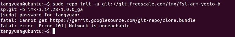

       When i do the repo init -u git://git.freescale.com/imx/fsl-arm-yocto-bsp.git -b imx-3.14.28-1.0.0.ga,it report the error

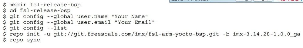

        Similarly,i do the step :4.jpg

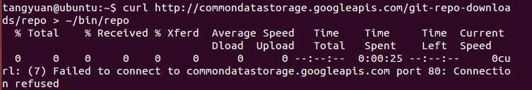

        curl http://commondataastorage.googleapis.com/git-repo-downloads/repo  >~/bin/repo
        It report the error:5.jpg
      Can anyone help me?
                                                                                                                                                                                                THANKS

Hello Tang Yuan,
Please make sure that you have internet access. In case you’re using a proxy please check your settings. Building the Yocto BSP requires an active internet connection at all times in order to download metadata and fetch the source code.
