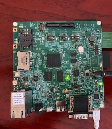

ramesh_r
Thanks Igor,
I have another board, this is iMX6 EVK
Board: MX6SX SABRE SDB
This is currently running linux ver 4.9.88.
1) Need to download the ARM toolchain,
2) Download the linux kernel source
3) build an image
4) need to upgrade / flash the newly built image to boot up the board.
Could you also point me to the documentation to get the above listed items done as well for iMX6?
Thanks in advance. Attaching a picture & HW Info for reference.
