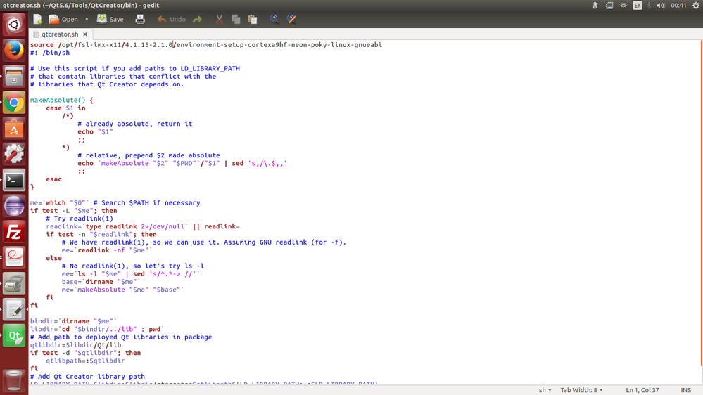

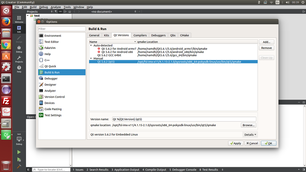

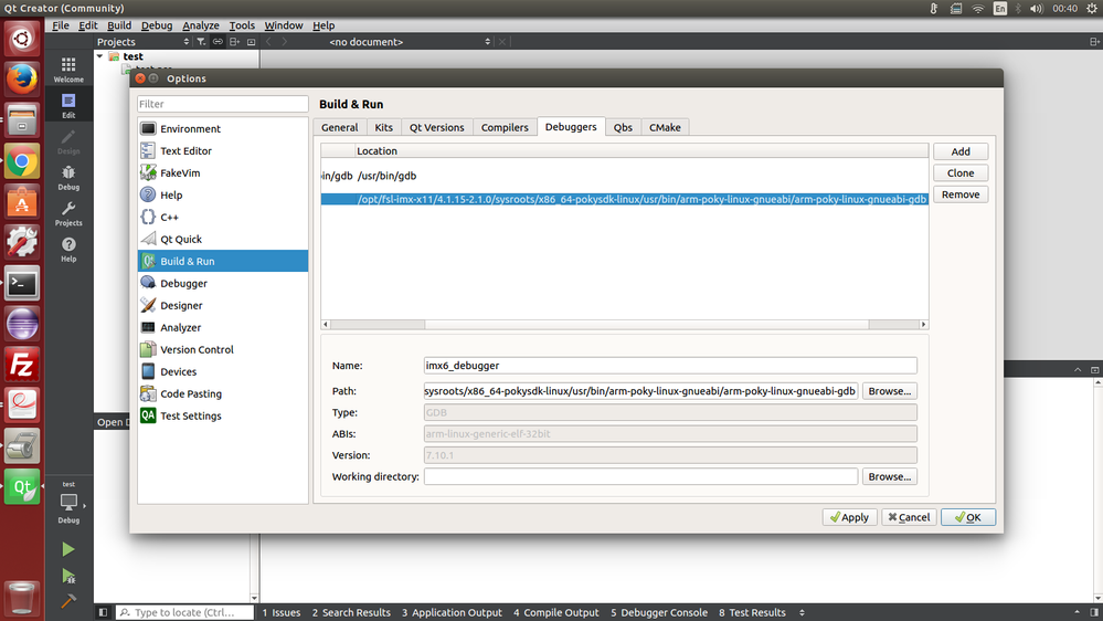

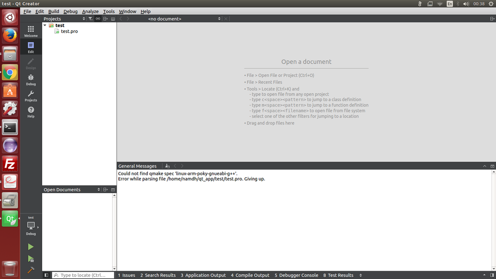

donam
I did follow your guide, but i didn't workh1.pngh2.pngh3.pngh4.pngh5.pngh6.pngh7.png@@
