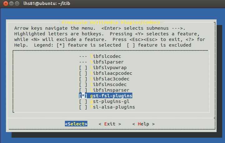

I am going to set camera system in csi0 paraller port of i.mx6 sabresd borad .
I was set gst-fsl-plugins and compile.
Build path taken because: directory build,
checking if sources have been updated: no
Processing: libtermcap
Processing: bash
Processing: zlib
Processing: net-tools
Processing: ethtool
Processing: wireless-tools
Processing: iproute
Processing: i2c-tools
Processing: hotplug
Processing: glib2
Processing: alsa-lib
Processing: libxml2
Processing: udev
Processing: dhcp
Processing: liboil
Processing: gstreamer-core
Processing: gst-plugins-base
Processing: gst-plugins-good
Processing: firmware-imx
Processing: imx-lib
Processing: imx-vpu-lib
Processing: imx-test
Processing: kobs-ng
Processing: wpa_supplicant
Processing: libfslcodec
Build path taken because: no prebuilt rpm,
Testing network connectivity
OK GPP:
Try libfslcodec-3.0.7-2.tar.gz.md5 from the GPP
http://bitshrine.org/gpp/libfslcodec-3.0.7-2.tar.gz.md5:
09:31:51 ERROR 404: Not Found.
Try libfslcodec-3.0.7-2.tar.gz from the GPP
http://bitshrine.org/gpp/libfslcodec-3.0.7-2.tar.gz:
09:31:52 ERROR 404: Not Found.
Can't get: libfslcodec-3.0.7-2.tar.gz at ./ltib line 802.
f_buildrpms() returned an error, exiting
traceback:
main:572
Started: Fri Mar  4 09:31:10 2016
Ended:   Fri Mar  4 09:31:52 2016
Elapsed: 42 seconds
These packages failed to build:
libfslcodec
Build Failed
Exiting on error or interrupt
How can i solve the problem?

  Please follow recommendations in the followoing documentation
http://www.nxp.com/webapp/Download?colCode=L3.0.35_4.1.0_LINUX_MMDOCS&Parent_nodeId=1337699481071706...
http://www.nxp.com/webapp/Download?colCode=L3.0.101_4.1.1_MM_CODECS&appType=license&location=null&Pa...
Summary Page :
i.MX 6 Series Software and Development Tool|NXP
