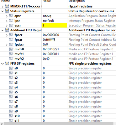

I have updated lpspi (5CHs)pin Mux and configs in pin_mux.c using config tool in app i called BOARD_InitPins() the control is not getting out of the function! it stuck somewhere,  with the following error
  • PC value is in some loop !
  • Register status :
  • Debug Message

please let me know if you any solutions for this, thanks

After importing the evkmimxrt1170_lpspi_edma_b2b_transfer_master_cm7 demo in the MCUXpresso, I add the pin initialization of the LPSPI3 in the BOARD_InitPins(), it doesn't encounter the above phenomenon during debugging the demo.

I figured out the problem i think can't use the LPSPI2 -LPSPI5 in EVK-MIMRT1170 only LPSPI1 and LPSPI6 pin_mux and Cfg is working !
i could see that in schematic spi1 and 6 is interfaced to Arduino pins
any work around to use all the SPI peripherals ?
