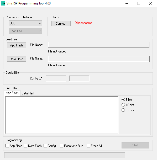

Hi All,
 I need to add bootloader support to my project so the customer can update the code remotely. I noticed there is a Kinetis Flash Tool and an open-source project in python. I need the project files to modify the bootloader for my own needs. Is there a Visual C++ or C# project I could get so I can modify it? I will be using MIMXRT1011 and MIMXRT1062 devices in my products and need to change how the program is used and gray out functions I don't want the customer to mess with.

Thank you for your quick response. I have taken a look at the document, and it gives a brief explanation of what I am after. I want to use UART1 to communicate with the application code and also be able to switch to bootloader mode through the same UART1 peripheral. I need more documentation that explains how to do this and also a utility/project I can modify so I can put my company logo and name of the utility etc. so it looks and is unique to my products as shown:
Note: It shows USB but I instruct the customer to choose the serial COM port in the dropdown
This was from Nuvoton and I have modified their bootloader tool for my own purposes. I used Visual C++ to modify the software for my own needs. Do you have a utility that is similar to the one shown above that I can modify for my own purposes?
I need something so I can get to market quickly and hope there is something that has already been done and that requires little effort to modify. Any help is appreciated :-).

Hi @enorton1379 ,
Thanks for your reply.
In my opinion, the GUI tool seems like the package of the command tool, so definitely, it can use other languages instead of Python to utilizing the command tools, and you can refer to the application note to learn how to use these command tools to program.
