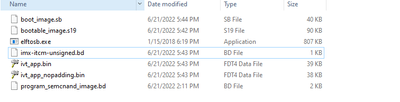

Generation of image

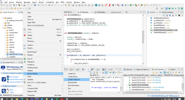

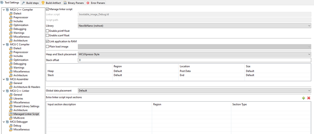

1. Using the MCU expresso IDE tool we generated .axf file. We have built this code in SRAM_ITC
2. Linker settings
                                                                                                                                                                       3. Generated srecord file using binary utils
4. Generated sb file using mfg tool
5. imx-itcm-unsigned.bd used from Flashloader_i.MXRT1050_GA\Flashloader_RT1050_1.1\Tools\bd_file\imx10xx

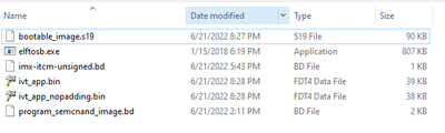

6. using the bd file we have generated the .bin files, below is the message
Flashloader_i.MXRT1050_GA\Flashloader_i.MXRT1050_GA\Flashloader_RT1050_1.1\Tools\elftosb\win>elftosb.exe -f imx -V -c imx-itcm-unsigned.bd -o ivt_app.bin bootable_image.s19
Section: 0x0
iMX bootable image generated successfully

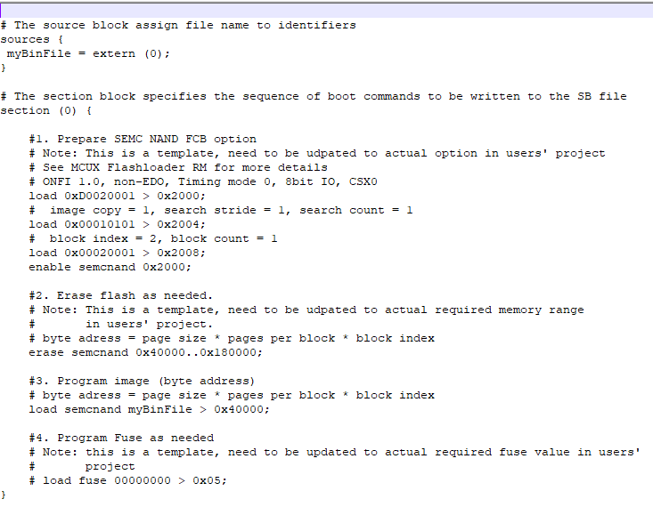

7. using .bin files  and .bd file (program_semcnand_image) generated sb file
\Flashloader_i.MXRT1050_GA\Flashloader_i.MXRT1050_GA\Flashloader_RT1050_1.1\Tools\elftosb\win>elftosb.exe -f kinetis -V -c program_semcnand_image.bd -o boot_image.sb ivt_app.bin
Boot Section 0x00000000:
FILL | adr=0x00002000 | len=0x00000004 | ptn=0xd0020001
FILL | adr=0x00002004 | len=0x00000004 | ptn=0x00010101
FILL | adr=0x00002008 | len=0x00000004 | ptn=0x00020001
ENA | adr=0x00002000 | cnt=0x00000004 | flg=0x0010
ERAS | adr=0x00040000 | cnt=0x00140000 | flg=0x0010
LOAD | adr=0x00040000 | len=0x00009bd8 | crc=0xec9f6501 | flg=0x0010

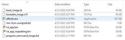

8. we have copied boot_image.sb file into this path
Flashloader_i.MXRT1050_GA\Flashloader_i.MXRT1050_GA\Flashloader_RT1050_1.1\Tools\mfgtools-rel\Profiles\MXRT105X\OS Firmware

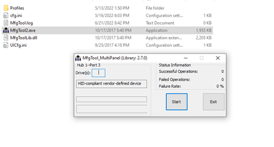

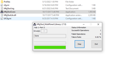

9. We used MMFG tool for flashing

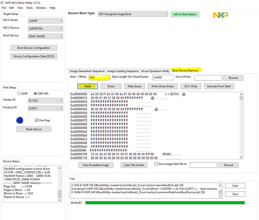

MfgTool log is also attached,

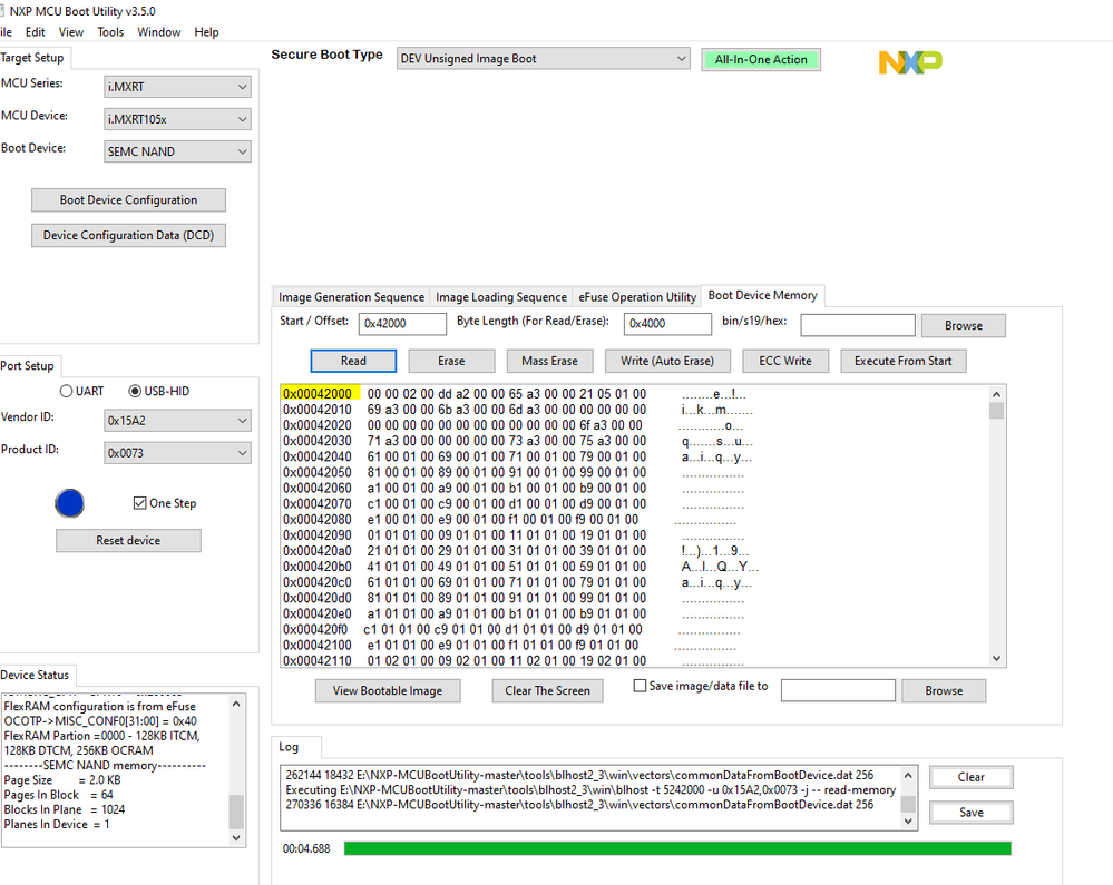

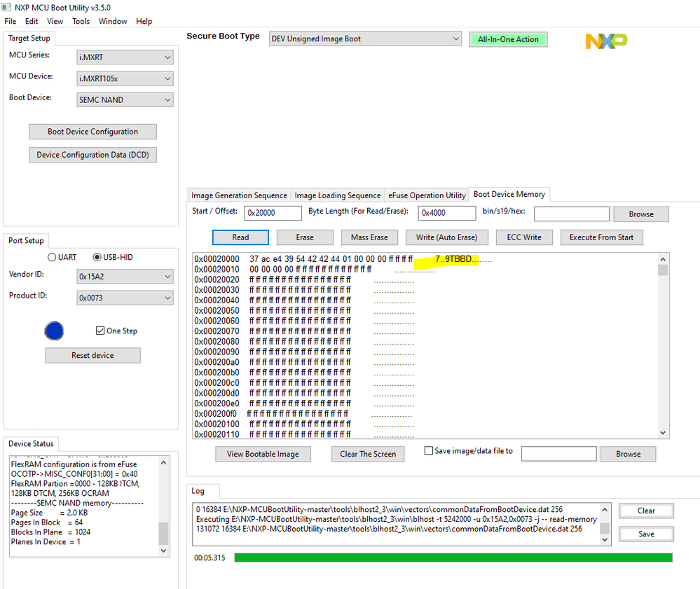

We confirmed by reading the image which is written is the same by using NXP MCU boot utility
After carrying out all these above steps, we were able to write the image with the mfg tool and able to read the image using the NXP MCU boot utility.

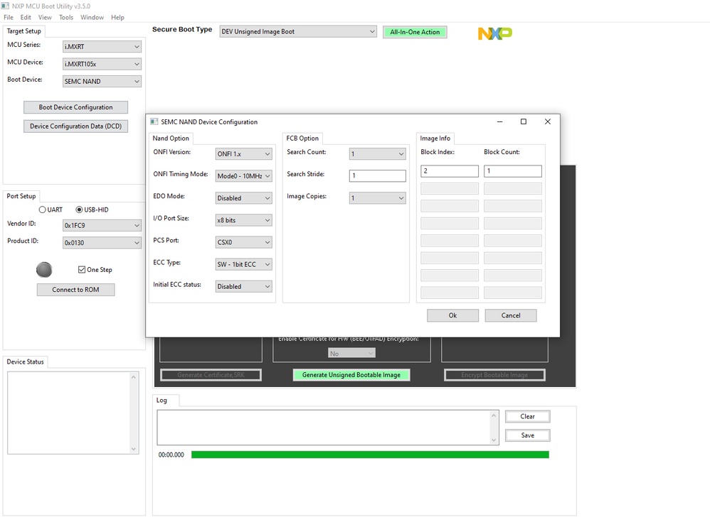

 We have set the boot configuration (GPIOS) to boot.
 Boot mode: Internal mode
 Boot configuration: NAND Flash( 001x b)
But we were unable to boot the image from SEMC NAND flash.
Need your support on booting the image from SEMC NAND flash.
Also Kindly assess whether the above procedure is correct or not? If not please let us know the correct procedure for booting semc NAND flash.

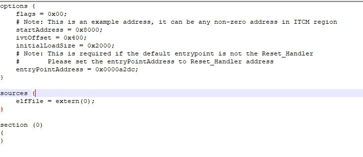

1,977 Views
jeremyzhou
Firstly, please comment out the enteryPointAddress and give it a try again.
Next, I'd like to suggest you use the NXPMCUboot utility to program the axf file directly, it's much easier than use the MfgTool.

venkataddagatla
We have tried the above-mentioned and commented out the enteryPointAddress. Still the image is not booting from the SEMC NAND flash.
Are there any other steps supposed to be done kindly suggest.

jeremyzhou
Thanks for your reply.
Whether you ever use the NXPMCUboot utility to program the s19 file directly, if not, please give it a try.

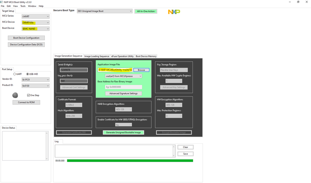

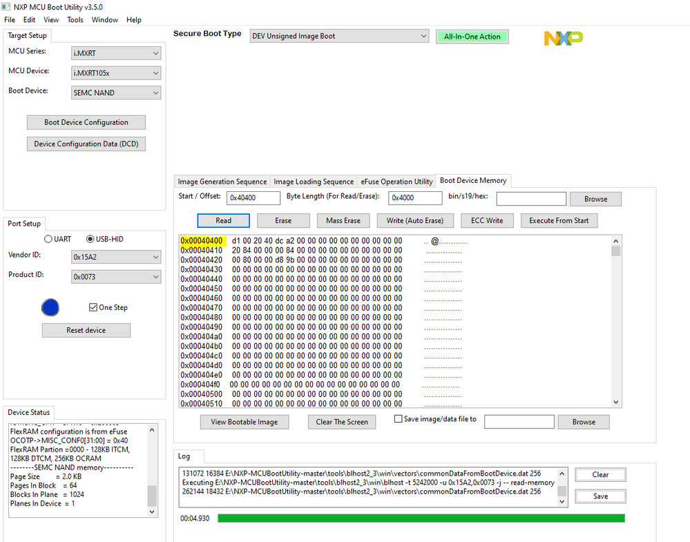

venkataddagatla
We can able to boot from the SEMC NAND by using the NXP MFG tool. But the same thing we can not able do is by using from NXP Boot utility as you suggested.
Actually, after booting the image from NAND we want to run that image from SDRAM. And it seems bit difficult to add dcd data in the NXP MFG tool.
But adding SDRAM dcd data in NXP boot utility is easier. The problem is we can not able to load the image and boot from NAND using the NXP boot utility.
We need support on this how we can run the image on SDRAM after booting from NAND flash.

jeremyzhou
I was wondering if you can share the bd files that be used to generate the SB file for the NXP MFG tool to download, further, I'd like to suggest the log of NXP Boot utility, it can help us figure out the cause of boot-up failure.
