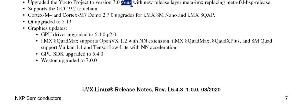

Hi Michael
nxp supports only yocto 3.0 Zeus as described below from
official linux documentation from i.MX Software and Development Tools | NXP
Issues with dunfell release can be posted on meta-fsl-arm mailing list
[email protected] | Home
igor
