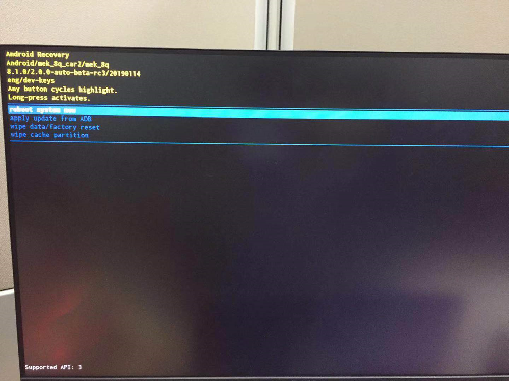

On Android O/P, recovery ramdisk is built into the boot.img. It can be triggered by run "reboot recovery" in android shell.
After reboot, it entering recovery, UI like this:
It actually needs to remove "skip_initramfs" in kernel command line to enter into recovery, as this: https://source.android.com/devices/tech/ota/ab/ab_implement#recovery

Thanks Eric, recovery mode works.
About a working mode suitable for running factory test commands, if "androidboot.mode=factory" not working on i.MX8M + Android 8.1, is there a proper mode you recommend?
