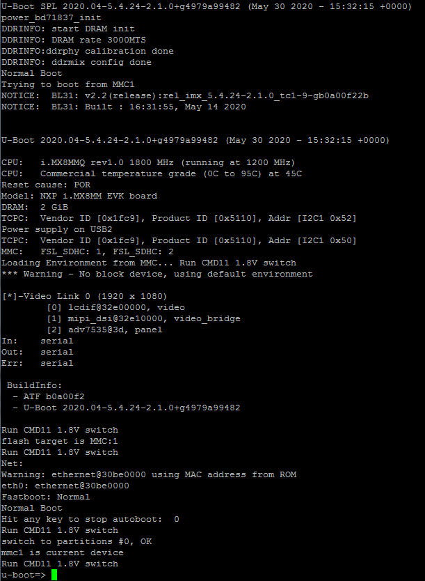

I previously created a 16G SD boot card and successfully started IMX8MMini EVK. I put imx-image-full-imx8mmevk.wic into the new 32G SD card, and want to boot the EVK using it today. Then, the console displays the following information and stops with uboot status. How to solve this problem?

one can check uboot bootcmd paramter in both cases:
https://www.denx.de/wiki/view/DULG/UBootEnvVariables
Also one can flash Demo Image i.MX 8M Mini EVK
igor

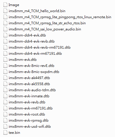

I have downloaded the demo image(L5.4.24-2.1.0_images_MX8MMEVK.zip) and dd 'imx-image-full-imx8mmevk.wic' into a 32G SD card. The 32G SD card includes the following files.error1.png
The EVK still stop in uboot mode after boot with the 32G SD card. I dd the same wic image into a 16G SD card and the EVK start OK. Is my steps of making the 32G SD boot card wrong?

so the same image works on 16G SD and not works on 32GB ?
Probably it is damaged.

Yes, I can boot EVK with 16GB SD card, but not works on 32GB at the same image.
Please try it in your local side. Thanks.
