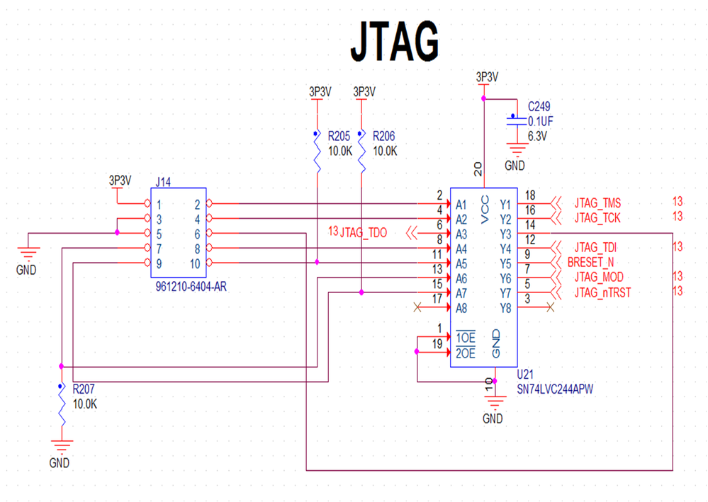

Using a custom board very similar to the Sabre Lite using an IMX6 quad core, the board is not booting.  Taking a step back, JTAG does not have a response (see output below) and can not ID the chip.  Power supplies were confirmed to be sequenced properly, are at the proper DC level, and are clean DC for both input supplies and generated supplies VDDARM23_CAP, VDDARM_CAP, and VDDPU_CAP.  Reset circuit signals are also correct, toggling ON 600ms after the supplies are stable.  If the power supplies are ok and the jtag connections are ok, is there anything else that could prevent JTAG from working?
I've confirmed also that the jtag tool and cabling works ok by using it on a Sabre Lite board.
Thank you for any suggestions you can offer.
JTAG circuit:
JTAG Output:

Hi Jeff
one can check that JTAG_MODE=0, NVCC_JTAG is applied.
For bsld operation one needs to have PCIE_VP, PCIE_VPH, PCIE_VPTX
powered (from Table 2-21. Recommended connections for unused analog interfaces IMX6DQ6SDLHDG)
One can also check sect.2.6 JTAG signal termination, Chapter 7 Configuring JTAG Tools,http://cache.freescale.com/files/32bit/doc/user_guide/IMX6DQ6SDLHDG.pdf?fasp=1&WT_TYPE=Users%20Guide...
check that 24MHz and 32.768KHz clocks are running.
Blowing fuse SJC_DISABLE disabes jtag (from Table 5-10. Fusemap Descriptions IMX6DQRM)

jeffkrupp
It was the clock source!  I changed it to a 16MHz and I am now able to JTAG ID the chip!  It is possible the 24MHz crystal was damaged.  I'll experiment further by changing to a new 24MHz source and step through the boot process.  It is great to see it finally has a pulse.  Thanks!

Thank you for your thoughts.  Here's what I checked:
JTAG_MODE is 0,
NVCC_JTAG is 3.3V,
PCIE_VP=VDDSOC_CAP(1.112V),
PCIE_VPH=2.5V
VCIE_VPTX=VDDSOC_CAP (filtered 1.112V)
JTAG terminations are outputs of a buffer IC that has pull-up\pull-downs as inputs, except TMS and TCK floating input to buffer, and TDO is a floating input to the buffer (no pullup\pulldown) per docs, so it all seems to comply.
The clock sources do not seem to be running.  I will try to get them running (perhaps it is a load capacitance problem), but I assumed the chip could run via jtag without the clock sources - do you know?
The IMX6 IC is new from a reputable distributor (Digikey), so the fuses should be default.  I can't confirm without JTAG working.
Thanks for your help.  If you know about whether clock sources are needed for JTAG, that would help further.  Also open to other ideas.

Hi Jeff
I noticed one more thing. Can you put pull-ups on TMS
and TCK pins. (pin #2 and #4). Also I see that your RESET_N
is pulled high (pin 10). Can you remove that pull-up and
scope this as well.

jeffkrupp
I scoped TDO before the buffer and confirmed as the JTAG output is reporting - it stays constant high.  Next, I added pull-ups to TMS and TCK, removed the reset pull-up and confirmed the same JTAG response.  I see that RESET_N toggles, as controlled by the JTAG software\hardware, but TDO stays high.
Thanks for your help, but it is still unable to jtag ID the chip.  If you have any other suggestions or ideas, I'm open to trying them\checking.

Hi Jeff
If power supplies are correct and despite TMS. TCK
activity if you see no signal on TDO, what comes to
my mind is that perhaps your SoC has enabled secure
boot with no JTAG. Are any fuses blown on this SoC ?

jeffkrupp
Well, I have (3) prototypes, all built with new chips from Digikey.  I don't have any way of knowing about the fuse status, but it should be running defaults.  Thanks for your ideas.

Hi Jeff
Can you scope JTAG_TDO before it goes into
the buffer ?
