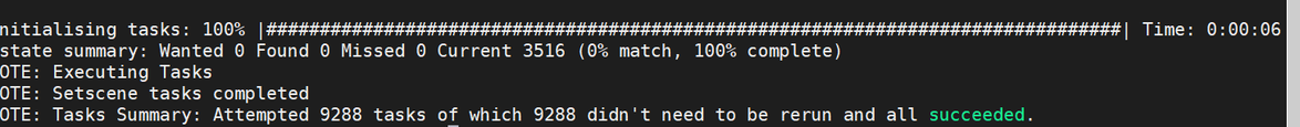

I'm bitbaking full image for imx8mpevk with BSP-5.4.70-2.3.2 and struggling with following error :
ERROR: onnxruntime-1.5.3-r0 do_unpack: gitsm: submodule unpack failed: UnpackError Unpack failure for URL: 'gitsm://github.com/onnx/onnx;protocol=https;name=cmake/external/onnx;subpath=cmake/external/onnx;bareclone=1;nobranch=1'. No up to date source found: clone directory not available or not up to date: /workdir/L4ES/spark-yocto-bsp-5_4_70-2_3_2/../../NXP/Boards/Common/Yocto/yocto_dl/v5.4//git2/github.com.onnx.onnx; shallow clone not enabled
ERROR: onnxruntime-1.5.3-r0 do_unpack: Unpack failure for URL: 'gitsm://github.com/onnx/onnx;protocol=https;name=cmake/external/onnx;subpath=cmake/external/onnx;bareclone=1;nobranch=1'. No up to date source found: clone directory not available or not up to date: /workdir/Dynimlabs/spark-yocto-bsp-5_4_70-2_3_2/../../NXP/Boards/Common/Yocto/yocto_dl/v5.4//git2/github.com.onnx.onnx; shallow clone not enabled
ERROR: Logfile of failure stored in: /workdir/L4ES/spark-yocto-bsp-5_4_70-2_3_2/build-xwayland/tmp/work/aarch64-poky-linux/onnxruntime/1.5.3-r0/temp/log.do_unpack.16020
ERROR: Task (/workdir/L4ES/spark-yocto-bsp-5_4_70-2_3_2/sources/meta-imx/meta-ml/recipes-libraries/onnxruntime/onnxruntime_1.5.3.bb:do_unpack) failed with exit code '1'
WARNING: armnn-onnx-1.3.0-r0 do_fetch: Failed to fetch URL git://github.com/onnx/onnx.git, attempting MIRRORS if available
ERROR: armnn-onnx-1.3.0-r0 do_fetch: Fetcher failure: Unable to find revision bae6333e149a59a3faa9c4d9c44974373dcf5256 in branch master even from upstream
ERROR: armnn-onnx-1.3.0-r0 do_fetch: Fetcher failure for URL: 'git://github.com/onnx/onnx.git'. Unable to fetch URL from any source.
ERROR: Logfile of failure stored in: /workdir/L4ES/spark-yocto-bsp-5_4_70-2_3_2/build-xwayland/tmp/work/aarch64-poky-linux/armnn-onnx/1.3.0-r0/temp/log.do_fetch.16006
ERROR: Task (/workdir/L4ES/spark-yocto-bsp-5_4_70-2_3_2/sources/meta-imx/meta-ml/recipes-libraries/armnn/armnn-onnx_1.3.0.bb:do_fetch) failed with exit code '1'

           The Problem is because of the branch name. Branch name should the main not master (Since Github default branch name changed to main), if not mentioned it will look for master.
So change the SRC_URI in /workdir/L4ES/spark-yocto-bsp-5_4_70-2_3_2/sources/meta-imx/meta-ml/recipes-libraries/armnn/armnn-onnx_1.3.0.bb as below.
SRC_URI = "git://github.com/onnx/onnx.git;branch=main"

Finally I figure out the issue: even-though I re-do everything from scratch as per steps I provided you,  armnn-onnx and onnxruntime packages are still unchanged in separate download folder :
DL_DIR ?= "/workdir/NXP/Boards/Common/Yocto/yocto_dl/v5.4/"
Together with the appending of "branch=main" into SRC_URI within armnx-onnx recipe, removing them from the separate download folder to force a new download of both packages solves the issue.
