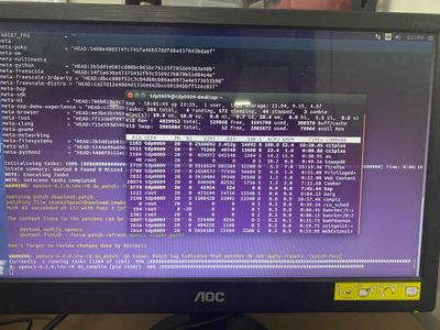

16,945 Views
milav_soni
Hello @weidong_sun
Thank You For Your Response.
I am trying to follow your steps to build only opencv for i.mx8m nano evk.
But the process is stuck at 80%. Please see snapshot for the same.
Is there hard disk/RAM error or else pc configuration is low for the same?
please help me out.
Thank You.

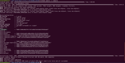

16,930 Views
weidong_sun
Hi @milav_soni
See below, please! Just finished.
My notebook is 32GB memory, and assign ubuntu 18.04 on vmware player 16GB memory and 4 cores.
So advise you to increase memory size of your PC or notebook.
Hope the test is helpful to you.
Have a nice day!
B.R,
Weidong
16,921 Views
milav_soni
Hello @weidong_sun
May i know your pc configuration? about processor and frequency?
My PC has "Intel Core2 Duo CPU [email protected] x 2" Processor.
So is this okay for these? i need to cross check only.
Thank You
