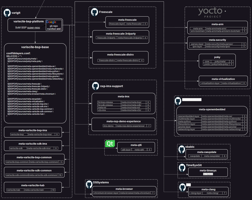

As I mentioned, I'm using the var-som-imx8mp "machine", with varigit/variscite-bsp-platform at mickledore as the "distribution". I was befuddled by their terminology and documentation, and the cognitive dissonance between it and the YP docs, until I forced myself to draw the diagram below, requiring me to dive deep.
variscite-bsp-platform is actually not a BSP. It "has a" BSP, defined in the depths of its `meta-{imx,var}-*-bsp` layers, but it is not a BSP. variscite-bsp-platform is a distribution. Even after understanding this distinction, it is confusing how to move forward with creating one's own distribution layer (per YP best-practices) which "uses" and modifies the variscite-bsp-platform distribution. The canonical "how-to" solution in the variscite documentation is "Add the following line to YOCTO_DIR/BUILD_DIR/conf/local.conf."
On top of these, the tooling used in these vendor BSPs is heterogenous and IMO a bit archaic:, e.g. using git-repo tool manifests instead of standard git submodules (yes, submodules are standard, folks, get used to it), and not standardizing on modern container tooling like kas.
I know the above are not your problem, nor your fault, Gustavo. I just wanted to provide some context around why I'm here, and perhaps what the OP found confusing.
..and to suggest and solicit feedback on a canonical solution for future users that like me want to follow YP best practices while using a vendor-provided yocto "distribution" which includes the "bsp" layers for "machine"-specific configuration. The approach is defined by the below list of requirements.

Visualization of variscite-bsp-platform, which I wish had been called a "variscite-reference-distro"Visualization of variscite-bsp-platform, which I wish had been called a "variscite-reference-distro"
