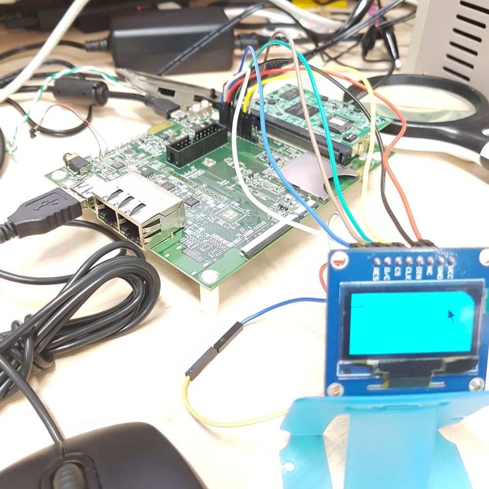

I'm using "iMX6ULL 14x14 evk" and enabled OLED 128x64 as below image.
Running image is based on yocto, core-image-sato, X11 is running.
As running X, you can see a mouse cursor in below image.
Now I want display small animated gif on this display, without any windows title bar.
How can I display animated gif on OLED?
What is the best recipe for displaying animated gif?
I want display this on OLED  128x64 (as Black and White).
