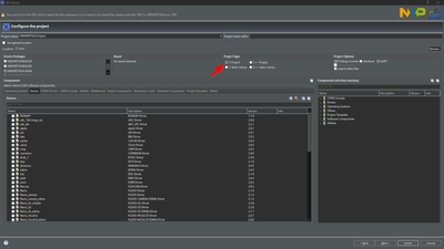

Hi!
We are trying to separate our baremetal sources into projects where the is one project containing our sources (let's call it application project) is referencing another project containing all the MCUXpresso SDK-generated for our MCU (MIMXRT1024CAG4A) and generating a library.
+-- Application project (generates an executable)
+-- MCUXpresso SDK project (generates a library)
The application project links to the library generated by the MCUXpresso SDK project and both use the same defines and the NewlibNano library.
The project only traces on the UART (we are using the UART for debug messages), the main, in the application project, being the following (almost identical to the one generated by default):

 This work well in debugging mode but when when attempting to flash the release mode image it does not work (i.e. no log is seen).
I tried to put all sources in one project and then it works in debugging and when flashing the release mode image.
What can be the problem with the release mode project separated in 2 projects?

I guess your image is lack of header data, such as FCB/IVT. So it can't boot by ROM.

Please see the evkmimxrt1020_flexspi_nor_config.c and fsl_flexspi_nor_boot.c. When you change linker script or address, they may disappear from linker file.
Jing

We did not modify the linker scripts that are automatically generated by MCUXpresso IDE (i.e. "Manage linker script" is checked in MCU Linker-->Managed Linker Script). When comparing the generated *.ld files from the two-projects build and the one-project build (i.e. working one) they are the same (only the generation date in the comment is different).
In the 2-project build, I tried to move the xip-related MCUXpresso SDK files from the library project to the application project and the flashed file is started when unplugging and replugging alimentation! Again, the generated .ld files are identical excluding the date.
This leads me to this question: is there a way to use sections from a library while linking the executable?
Thanks!
5,249 Views
jingpan
Hi @rvigneault ,
It seems couldn't. You can put these data in your second project.
Jing
