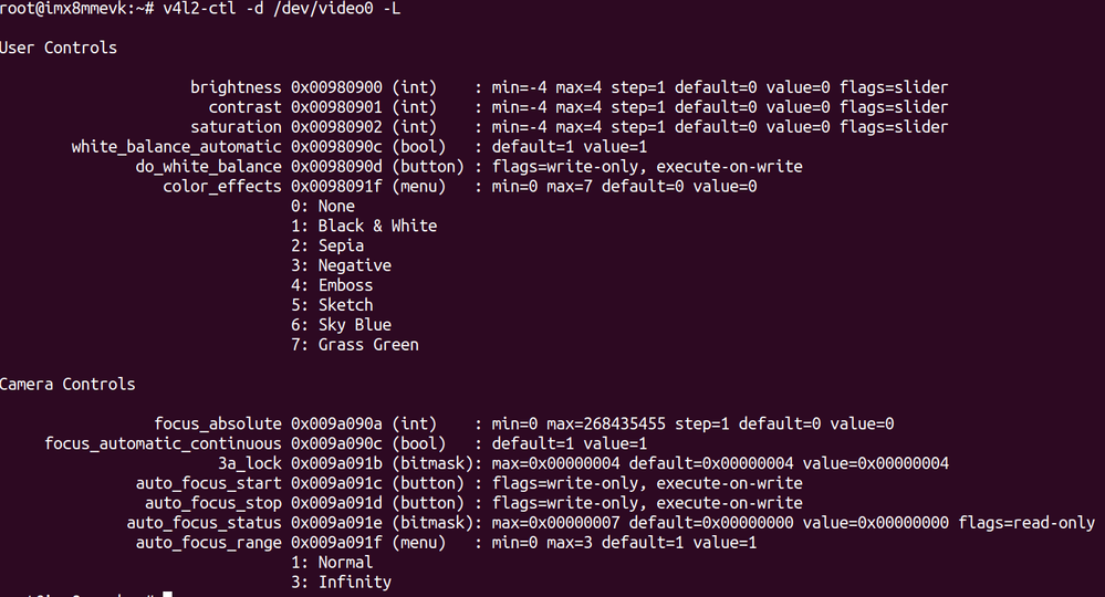

Hi all,
I want to configure OV5640 with autofocus onIMX8MM. My BSP version is 5.4.70. Can someone provide me a lead?
Ajita

Those who want to integrate Auto focus with OV5640 on IMX8MM. Please follow below link for reference:
https://github.com/boundarydevices/linux/tree/boundary-imx_5.15.y/drivers/media/platform/mxc/capture
Change kernel version according to you BSP. By referring files preset in mentioned directory you can enable below functionalities:
Auto focus functionalityAuto focus functionality
You need to have OV5640 module with VCM. Above driver implementation doesn't support continuous auto focus. User need to pass "v4l2-ctl -d /dev/video0 -c auto_focus_start=1" command each time to get focus.

auto focus doesn't defined in the dts file, should support in the ISP v4l2 API, you can refer to the document as below:
"https://www.nxp.com/products/processors-and-microcontrollers/arm-processors/i-mx-applications-proces..."
for more detailed information, pls contact professional service support team
"https://www.nxp.com/support/support/nxp-engineering-services/professional-support-for-processors-and..."
