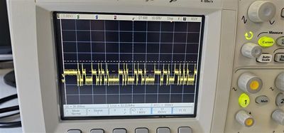

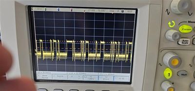

freshmango90
Hello @jamesbone
Our setup is as such:
External SoC --> Level shifter (3.3V to 1.8V) --> imx8mp
We have the oscilloscope probed at the RX line of the imx8mp (SAI1_RX_DATA00). This is what we see:
The highest voltage never reaches 1.8V, and the high seems to be at 0.85V, which is too low and never gets registered as high in the imx8mp RX line.
If we unplug the RX line from the imx8mp while everything is intact, the oscilloscope jumps up above 1.8V, as shown:
The oscilloscope is reading what is coming from the SoC via level shifter.
My question is, why is connecting the imx8mp RX line pulling the voltage down such that the high doesn't trigger as 1 in the input, thus producing complete silence in the eyes of imx8mp?

Manuel_Salas
Hello @freshmango90
It seems that you have enabled pull-down on the RX pin on i.MX8MP.
Could you please share your device tree related to the the SAI configuration? If possible, share the schematic and part number of the level shifter.
Salas.
