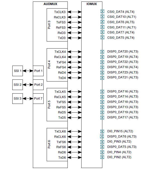

Hello All,
I have a custom board similar to SabreLite which has linux 3.10.17 kernel  running. Now I am trying to bring up sound on this board. The coded is  uda1380 codec that interfaced  through esai.
The codec used 3 Tx paths and 2 Rx paths
If my understanding is correct, I need to configure following module to bring up audio in my .dts file
1. esai
2. codec
3. clocks for codec
I am little puzzled with the Audio sus bsystem used in i.MX6Q,
There are two queries I have.
1. Do I need to configure audio port mux if i use standard I2S communication to codec and ALSA ?
2. Is there any application note which I can refer to understand better  on Audio subsystem.
Also the uda1380 codec does not support device tree configuration, any one used this driver with latest kernels?

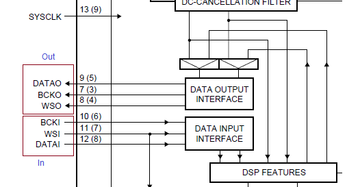

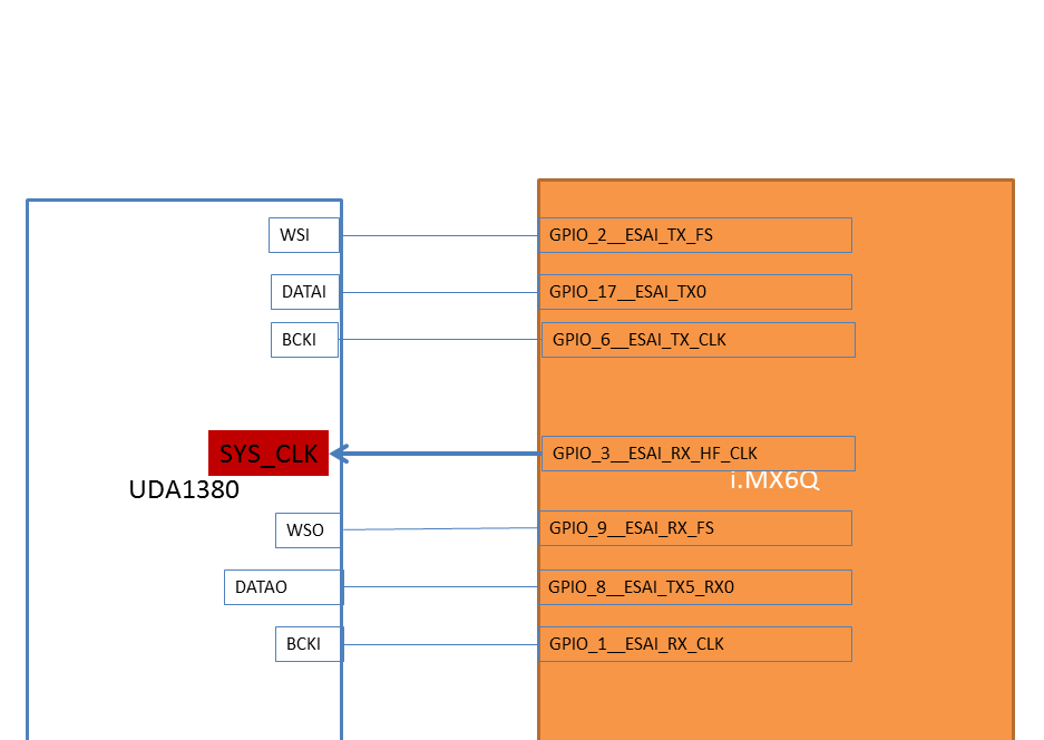

krishnanp
The connections between i.MX6 and codec (uda1380)  is below.
i.MX6 SideUDA1380
I2S_FSR/GPIO_9I2S0_WSO
I2S_FST/GPIO_2I2S0_WSI
I2S_HCKR24 MHzOSC
I2S_SCKR/GPIO_1I2S0_BCLKO
I2S_SCKT/gpio6I2S0_BCLKI
I2S_TX0/GPIO_17I2S0_TXD
I2S_TX5_RX0/GPIO_8I2S0_RXD
The device get detected in i2c bus with address 0x18,but not able to register the codec driver.

The pinctrl goup added in imx6qdl.dtsi
    pinctrl_esai_3: esaigrp-3 {
                        fsl,pins = <
                                MX6QDL_PAD_GPIO_2__ESAI_TX_FS          0x1b030
                                MX6QDL_PAD_GPIO_3__XTALOSC_REF_CLK_24M 0x1b030
                                MX6QDL_PAD_GPIO_1__ESAI_RX_CLK       0x1b030
                                MX6QDL_PAD_GPIO_6__ESAI_TX_CLK        0x1b030
                                MX6QDL_PAD_GPIO_17__ESAI_TX0             0x1b030
                                MX6QDL_PAD_GPIO_8__ESAI_TX5_RX0       0x1b030
                                MX6QDL_PAD_GPIO_9__ESAI_RX_FS          0x1b030
Any idea what can be the  problem here. your suggestion are welcome.

Hello Krishnan,
     I checked datasheet of UDA1380, and the following is my advice for you, hope they can help you:
(1) I2S interface on UDA1380
The interface to CPU is I2S input and I2S output, so you can try to configure SSI port as 6-wire communication.
(2)CPU side(SSI connections to AUDMUX and external PADs)
What the above diagram shows should be configured in BSP file , you can refer to our evaluation board files.

krishnanp
Hello Weidong,
I was out of the town for  couple for weeks.  Firstly thank you for your input.  I have wrote the machine driver and able to see the sound card get detected.
See the below logs.  I am able to run aplay and speaker test, There is some beep coming out of the speaker but not the expected sound.  Looks like something to do with clock configuration..
The sysclk of codec is connected to  GPIO_3__ESAI_RX_HF_CLK  of i.MX6.
My intention is to provide master clock from i.MX6 to codec so the codec should work as clock slave. However i.MX6 reference manual says this pin can be configured in 3 modes.
MX6QDL_PAD_GPIO_3__CCM_CLKO2
MX6QDL_PAD_GPIO_3__ESAI_RX_HF_CLK
I am bit puzzled with which mode I should select. Does ESAI_RX_HF_CLK mode can provide the sys_clock to Codec?
Also  another question about ASRC. Do we need toenable ASRC to make ESAI work? Or ESAI can work without ASRC ?
Appreciate your inputs.
Thanks in advance.
