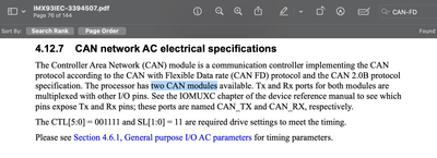

After thoroughly reading the user manual, we have a question regarding the two CAN_TX and CAN_RX pins for the I.MX93. We noticed that the manual mentions "The processor has two CAN modules available," but we couldn’t find CAN_TX and CAN_RX listed in the functional contact assignment section. Could you please point us to the correct location for this information?

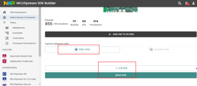

Additionally, could you guide us on where to download the SDK for the I.MX93 to begin programming the processor and locate the correct pin positions? We’ve searched on the following site but couldn’t find the SDK: https://www.keil.arm.com/vendors/nxp/devices/.

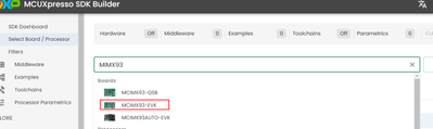

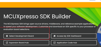

You can build your SDK from here:
https://mcuxpresso.nxp.com/en
