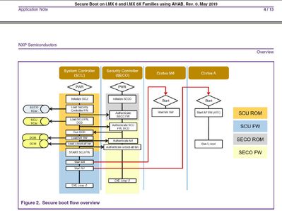

all mentioned links are public links, with free access. In particuar one can look at AN12312
Secure Boot on i.MX 8 and i.MX 8X Families using AHAB

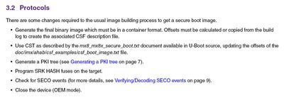

igorpadykov
> if I do a bitbake virtual/kernel -c menuconfig, where is the ARM architecture->
>Support i.MX 8 AHAB features located in the configuration?
what do you mean exactly as per p.7 AN12312 there are several changes should be done
compared to usual image (they are not performed by bitbake and with menuconfig):

The details of enabling AHAB are in the attachments from NXP. What you sent is too high level.
See the attached slides beginning with Secure Boot - U-Boot.  The step by step guide is found under section 3.4 Examples in AN12312.pdf. The Step by Step Guide has the following under section 1.2 Preparing U-boot to support AHAB:
    CONFIG_AHAB_BOOT=y
  - Kconfig:
    ARM architecture -> Support i.MX 8 AHAB features"
Again, I don't find these in either the u-boot defconfig nor in the Kernel .config. I can add it to the U-boot defconfig and see if I see the AHAB commands, but not able to configure the kernel config using menuconfig. The following is from the attached slides.
