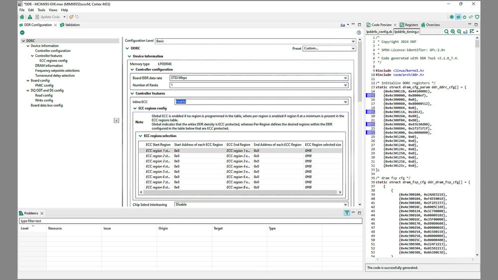

jmp
I haven't found anyone yet, but do you have this tool?
https://www.nxp.com/design/design-center/development-boards-and-designs/i-mx-evaluation-and-developm...
I'm pretty sure all we did was generate the initial file by filling in the device info on the DDR screen. After you choose the part number when creating a new project, you go to the DDR screen using the menu at the top. It will load a table that you fill in the module info. This will update the tabs on the right with the .ds and the timing.c files. You can see the tabs I'm talking about in the second screenshot on the tool's main page (see below).
CONFIG-TOOLS-DDR-TOOL
I believe these are the settings from the datasheet that go in the table.

Without the pins to run the tool, though, you won't be able to tune the settings or run the validation tests. From experience, you may end up with some very tricky bugs down the road without doing those steps.
