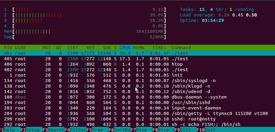

I have embedded device with Freescale I.MX6 SoC.  I compile Qt5.3.1 from source with support OpenGL and when I run my application I have very large use cores of I.MX6 instead use GPU at max. Other more complex animations use core of CPU even greater. Look at the htop screenshot. If I build my QML application for Windows Angle CPU of PC load at 2...3% -  GPU works at maximum.  Does works OpenGLat I.MX6 correctly or for embedded Qt is it normally (i mean great load core CPU)?
The Linux kernel is 3.10.17
Source of test application:

Could you please provide more information on what BSP version you are using. Is it X11 or EGLFS backend?
Tried QML based applications built with Yocto project, and GPU is fully utilized.

My board is var-som-mx6 quadro of the variscite. File system built by buildroot 3.10.17.
Backend is EGLFS. No X11. When I run QML animation I see increase power consumption up to +5 watts. I think this is due to the activation of GPU.
Tell me please how loaded your board cpu cores when you run QML animation?

CarlosCasillas
They have mentioned that on Cinematic Experience is 10 to 20% and wiggly is 12% CPU.

Thank you for your answer. I am sorry but if possible say me - 10...20% is it summary(total) load for CPU(for 4 cores) or load of single core of quadro cores CPU?

CarlosCasillas
It is total load (top).

dmitrypozhidaev
Thank you! It is same as i have. But it is a bit sadly.
