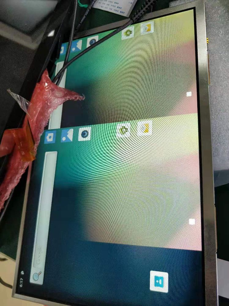

aber
hello @传策 薛 , 8mm Driver lt9211 display screen split screen jitter encountered ?e2c36e543d2bd1db3380d478201b0f5.jpg
5,093 Views
zhouyq
Hello, I also encountered this problem, how did you solve it?
