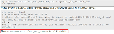

Leo-Ze
Hi Zhiming,
now I use is android 13 (kernel 5.15), According to user guide...
I think is the same thing(abi_gki_aarch64.xml)?
If so, then despite updating the abi_gki_aarch_imx and abi_gki_aarch64.xml files
I'm still encountering the "Unknown symbol" issue.
It seems like I might have missed some crucial steps...
Could you please provide a more detailed approach?
Thanks.

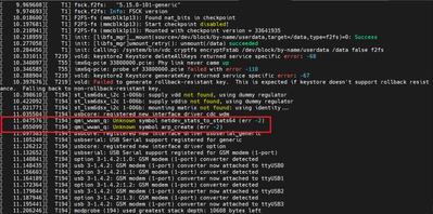

Leo-Ze
Hi Zhiming,
I referenced the following step: Export-new-symbols
The abi_gki_aarch64_imx and abi_gki_aarch64.xml files have been updated,
abi_gki_aarch64_imx.pngabi_gki_aarch64_imx.pngabi_gki_aarch64_xml.pngabi_gki_aarch64_xml.png
then I copied the abi_gki_aarch_imx and abi_gki_aarch64.xml files to the NXP kernel directory:
"android_build/vendor/nxp-opensource/kernel_imx/android/"
and after recompiling and flashing, the "Unknown symbol error" still appears during boot-up, as shown in the previous image:
qmi_wwan_q: Unknown symbol netdev_stats_to_stats64
qmi_wwan_q: Unknown symbol arp_create
Additionally, I would like to inquire about the step "update abi_gki_aarch64.stg".
What does this step entail? I couldn't find any relevant information in the User Guide.
Thanks.

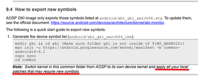

Zhiming_Liu
Hi @Leo-Ze
Please refer this :
Best Regards
Zhiming

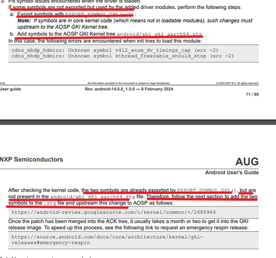

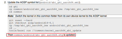

4,580件の閲覧回数
Zhiming_Liu
Hi @Leo-Ze
Have you finish the 9.4 How to export new symbols? You need update abi_gki_aarch64_imx first and then update abi_gki_aarch64.stg.
