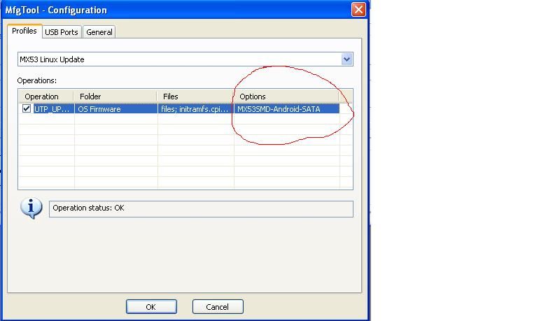

4. MFG tool
Copy all android relative image files to "files/android"
