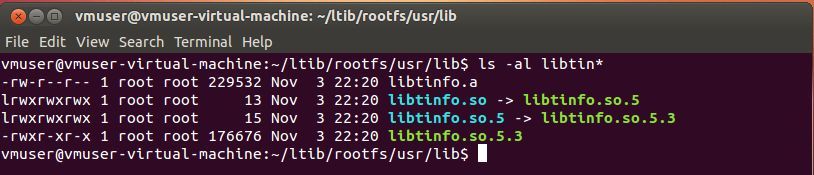

When build alsa-utils from ltib, in ubuntu 12.04 x86_64, you may meet this error:
checking for new_panel in -lpanel... no
configure: error: panel library not found
error: Bad exit status from ….
The workaround is
1. Make sure if libncurses.so exist in ltib/rootfs/usr/lib/, if not, build it with command “$ ./ltib -p ncurse”.
2. Create soft link libtinfo.so to libncurse.so
     $ cd rootfs/usr/lib
     $ sudo ln -s libncurses.so libtinfo.so
Then you can build alsa-utils by “$ ./ltib -p alsa-utils”

Hello, Shaojun,
Thanks for the insight to fix the alsa-utils build issue in Ubuntu 12.04 64bit OS; which is to create soft link libtinfo.so to libncurse.so in the rootfs.
Alternative, it could add --with-termlib option to the ltib/dist/lfs-5.1/ncurses/ncurses.spec; which are:
%Build
CFLAGS="%{optflags} -DPURE_TERMINFO -DSVR4_CURSES"
%define optflags $CFLAGS
if [ "$GNUTARCH" != m68knommu ]
then
./configure --prefix=%{_prefix} --host=$CFGHOST --build=%{_build} \
    --with-install-prefix=$RPM_BUILD_ROOT --mandir=%{_mandir} \
    --with-shared  --without-debug --without-cxx-binding --with-termlib
else
    --without-shared  --without-debug --without-cxx-binding
fi
make -j1 HOSTCC="$BUILDCC"
Then, it will generate the following files which is needed by alsa-utils
