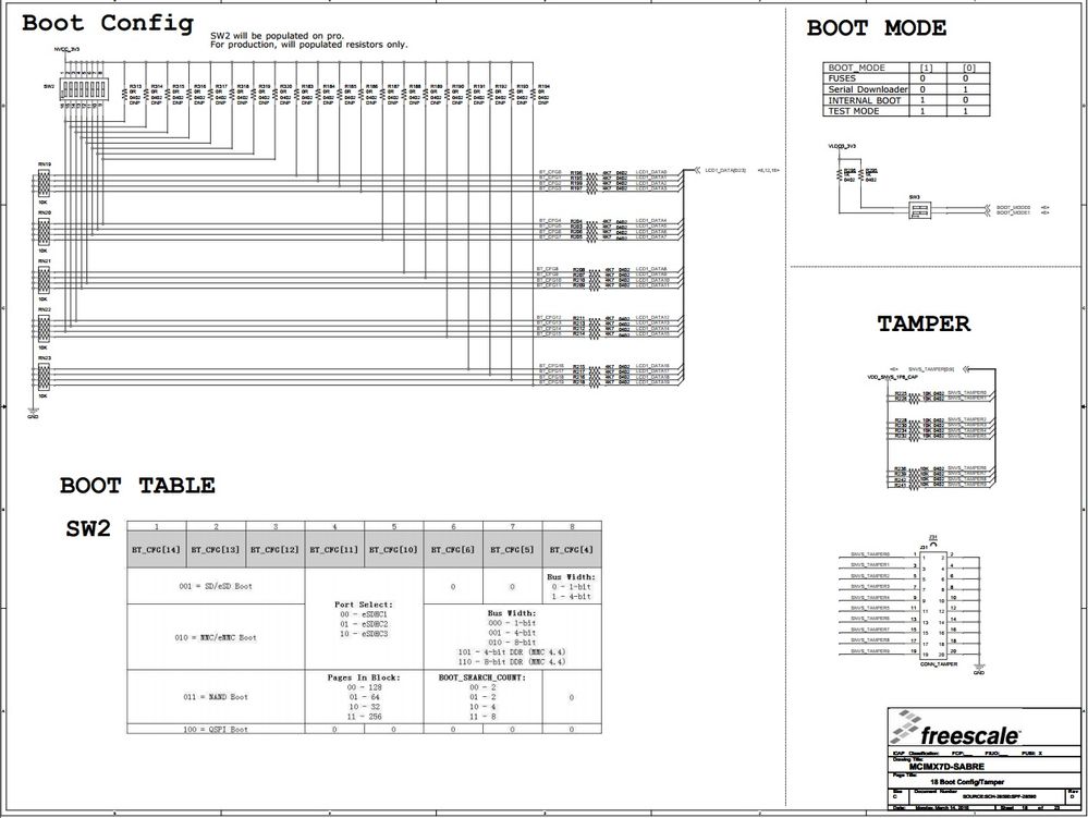

6.1.6 Booting from SD on the i.MX 7Dual SABRE-SD board
It is written as follows.
Download mode (MFGTool mode)SW4: 00100000 (from 1-8 bit)
Boot_Mode: 01 (from 1-2 bit)
SD bootSW4: 00111000 (from 1-8 bit)
Boot_Mode: 10 (from 1-2 bit)
To boot from SD, perform the following operations:
Chang the board Boot_Mode switch to 10 (from 1-2 bit) and SW4 00100000 (from 1-8 bit).
I think that SW4: 00111000 (from 1-8 bit) is the correct answer.
Which is the correct answer?
AndroidTM Quick Start Guide Rev. N7.1.1_1.0.0, 03/2017
It is written as follows P.31
9. Change SW3 (boot mode) to 10 (from 1 bit to 2 bit). Change SW2 to switch the board back to SD4 boot mode
00100000 (SD), 01010000 (eMMC), 011XXXX0 (NAND).

  The schematic (linked below) shows SW2 should be set as 00100000 to boot SD1
Design files for i.MX 7Dual
Summary page :
i.MX 7Dual SABRE Board|NXP
