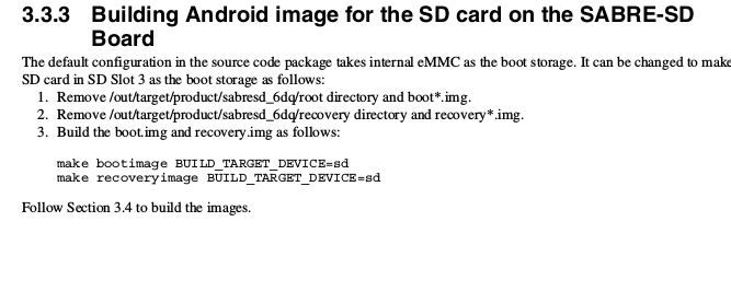

I have tried to build the image of android imx6qsabresd. The image was build successful and I have followed  as per instruction given in Android user guide pdf but the thing is when I flash the image in SD CARD and put into sabresd Development board but I was getting error continuously
binder: 196:196 transaction failed 29189, size 0-0
I have also tried with Pre-built image but I was getting same error.
May I know why this error was getting. Hope am waiting for your kind reply.

JayTu
From your log, you are trying to mount emmc instead of SD card.
Then android can't find necessary command to boot up,
init: error opening block device /dev/block/mmcblk3p2: No such file or directory
init: cannot find '/system/bin/logd', disabling 'logd'
init: cannot find '/system/bin/vold', disabling 'vold'
init: cannot find '/system/bin/tzdatacheck', disabling 'exec 0 (/system/bin/tzdatacheck)'
init: cannot find '/system/bin/logd', disabling 'logd-reinit'
Make sure you are building bootimage for sd as below,
make bootimage BUILD_TARGET_DEVICE=sd
You can also check vold.fstab to see if it mounts emmc or SD.

lakshmikanthr
Thank you for kind reply.
I have tried  as per instruction , make bootimage BUILD_TARGET_DEVICE=sd but I was getting same binder error failed.
Please check the attachment of log file and capture image
As per above instruction I have done but I was got same binder failed error. Do you have any idea regrading this.
