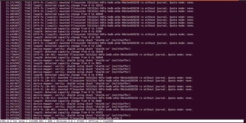

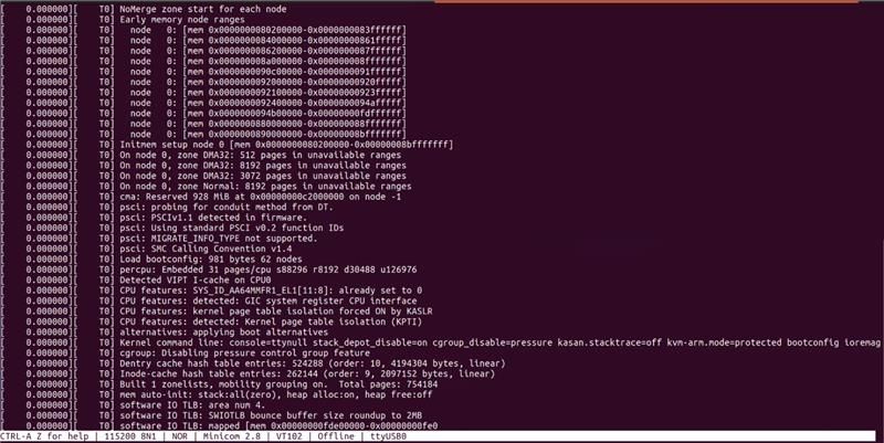

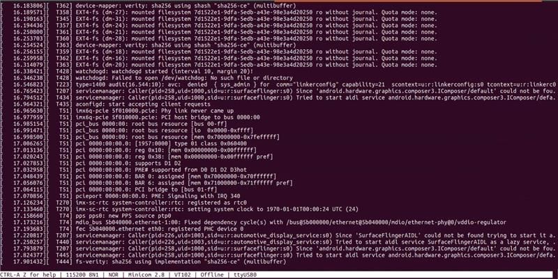

However, when we try to boot the board, here’s what happens:
  • The NXP loading screen appears for about a minute. As attached below , SB_Cbe_1-1761714268402.png
  • Then the display turns off (no Android UI).
  • On the serial console, we can see boot logs (screenshot attached).
  • The same issue occurs when we build Android 15 from source package (automotive-15.0.0_1.3.0_source) — flashing works fine, but the scenario is same as that of the pre-built image as described above.
Are there known issues or patches needed for display or GPU initialization on this board? Any guidance or troubleshooting pointers would be really helpful!
