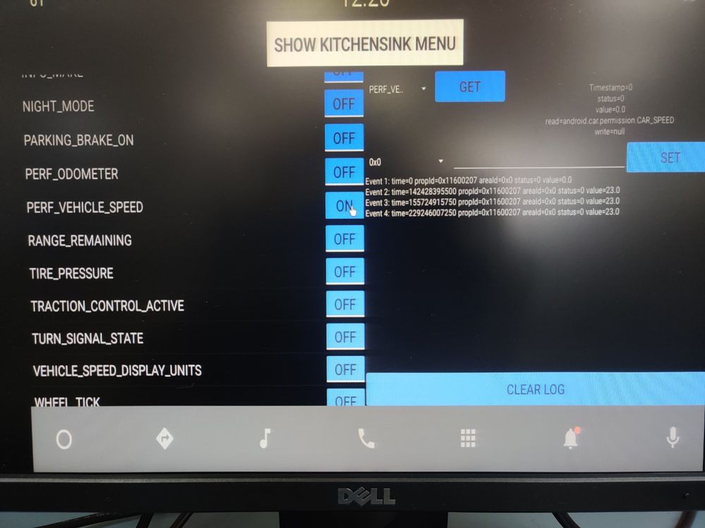

for example PERF_VEHICLE_SPEED
Open the KitchenSink application -> select property tab -> enable PERF_VEHICLE_SPEED
send the following command from terminal,
     dumpsys activity service com.android.car inject-vhal-event 0x11600207 23
Provide your full log also
VinothS,

shriyanayak1992
Hi vinothkumars‌,
what are those numbers in the above command?
This is the log when i do a dumpsys after selecting perf_vehicle_speed

 i have attached complete log and screenshot as well.

This the message id and it's defined in types.hal
* Speed of the vehicle
* @change_mode VehiclePropertyChangeMode:ON_CHANGE|VehiclePropertyChangeMode:CONTINUOUS
* @access VehiclePropertyAccess:READ
* @unit VehicleUnit:METER_PER_SEC
PERF_VEHICLE_SPEED = (
0x0207
| VehiclePropertyGroup:SYSTEM
| VehiclePropertyType:FLOAT
| VehicleArea:GLOBAL),
0x11600207
1 -> SYSTEM = 0x10000000,
1 -> GLOBAL = 0x01000000,
60 -> FLOAT = 0x00600000,
207 -> Alternative numaber
