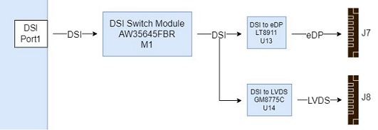

NXP reference design code base:
i.MX8MQ platform / Android 13.0.0_2.0.0 (L6.1.22_2.0.0 BSP)
LCDIF connected to MIPI-DSI on Android 13(GKI) that does not work, but the function can work on Android 11.
Android 11 Log:(Android11_LCDIF_OK.log)
[ 3.511971] nwl-dsi 30a00000.mipi-dsi: [drm:nwl_dsi_probe] Using LCDIF as input source

Android 13 Log:(Android13_LCDIF_Fail.log)
[ 2.401658][ T8] nwl-dsi 30a00000.mipi-dsi: [drm:nwl_dsi_probe [nwl_dsi]] Using LCDIF as input source
[ 2.412617][ T8] [gm8775c_bridge_attach] DRM_BRIDGE_ATTACH_NO_CONNECTOR
[ 2.419684][ T8] [drm:drm_bridge_attach] *ERROR* failed to attach bridge /soc@0/bus@30800000/i2c@30a20000/gm8775c@2C2
[ 2.419734][ T1] __power_supply_register: Expected proper parent device for 'battery'
[ 2.420045][ T1] __power_supply_register: Expected proper parent device for 'usb'
[ 2.432612][ T8] [drm:drm_bridge_attach] *ERROR* failed to attach bridge /soc@0/bus@30800000/mipi-dsi@30a00000 to en2
[ 2.460891][ T8] mxsfb 30320000.lcd-controller: error -EINVAL: Failed to attach bridge
[ 2.469098][ T8] mxsfb 30320000.lcd-controller: error -EINVAL: Cannot connect bridge
[ 2.477247][ T8] mxsfb: probe of 30320000.lcd-controller failed with error -22

BTW, we thought DSI to LVDS bridge driver (gm8775c) can work, because we use &dcss instead of &lcdif, DCSS connected to MIPI-DSI of Android 13 can work.

Hi @KyleChang
Does mxsfb equals lcdif ??
--> The lcdif driver in i.MX8MQ is drivers/gpu/drm/mxsfb/mxsfb_drv.c, so it is mxsfb.  mxsfb-drm can't be initialized because bridge attach failed
It looks like relates to the way of handling DRM_BRIDGE_ATTACH_NO_CONNECTOR flag. Can you check this point?
The mxsfb will not pass the DRM_BRIDGE_ATTACH_NO_CONNECTOR, but dcss driver will.
ret = drm_bridge_attach(&mxsfb->encoder, bridge, NULL, 0);
	if (ret)
		return dev_err_probe(drm->dev, ret, "Failed to attach bridge\n");
	mxsfb->bridge = bridge;
