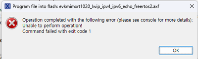

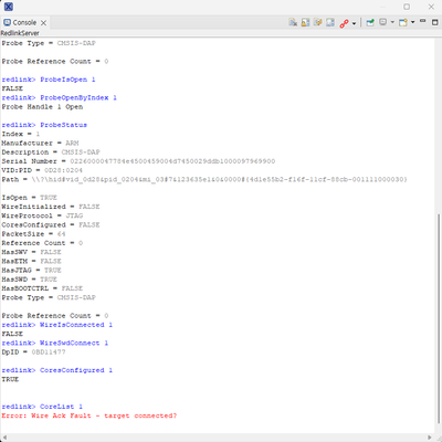

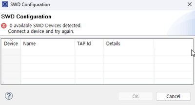

IMXRT1020 board
I added sdram initializing code and delete preprocessor XIP_BOOT_HEADER_DCD_ENABLE=1  in example lwip-echo-freertos,
After Example lwip_ipv4_ipv6_echo_freertos,  flash programming  board is not working,
and.. Flash programming is not  impossible.
From this page https://community.nxp.com/t5/i-MX-RT-Knowledge-Base/RT-board-recovery-for-debugger-connect-issues/ta...
Recovery is complete ,  Anyway attached my project,     Please test this  project    by  programming  this binary  on Board flash,  What is wrong.??

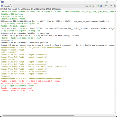

I did a test with RT1020 EVK board using attached code.
I could regenerate your mentioned issue (debugger lost connection).
While, I can follow this thread mentioned way to recover the board.
First of all, please make sure you set the board SW8 (on the board bottom side) with serial download mode:
    1) SW8: 1-OFF,2-OFF,3-OFF,4-ON
    2) Power off and power on again, or Press Reset button
Below is my test result:
After that, change SW8 back to 1-OFF,2-OFF,3-ON,4-OFF, then you can debug another project as expected.
Wish it helps.
