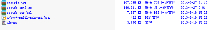

After Download ubuntu image by Mfgtool ,it trys to Downloading Images by  NFS.
Why?
U-Boot 2009.08 (Aug 16 2013 - 12:25:07)
CPU: Freescale i.MX6 family TO1.1 at 792 MHz
Thermal sensor with ratio = 188
Temperature:   35 C, calibration data 0x5a500000
mx6q pll1: 792MHz
mx6q pll2: 528MHz
mx6q pll3: 480MHz
mx6q pll8: 50MHz
ipg clock     : 66000000Hz
ipg per clock : 66000000Hz
uart clock    : 80000000Hz
cspi clock    : 60000000Hz
ahb clock     : 132000000Hz
axi clock   : 198000000Hz
emi_slow clock: 99000000Hz
ddr clock     : 396000000Hz
usdhc1 clock  : 198000000Hz
usdhc2 clock  : 198000000Hz
usdhc3 clock  : 198000000Hz
usdhc4 clock  : 198000000Hz
nfc clock     : 24000000Hz
Board: i.MX6DL/Solo-SABRESD: unknown-board Board: 0x61011 [POR ]
Boot Device: MMC
I2C:   ready
DRAM:   1 GB
MMC:   FSL_USDHC: 0,FSL_USDHC: 1,FSL_USDHC: 2,FSL_USDHC: 3
*** Warning - bad CRC or MMC, using default environment
In:    serial
Out:   serial
Err:   serial
Found PFUZE100! deviceid=10,revid=10
Net:   got MAC address from IIM: 00:04:9f:02:68:be
FEC0 [PRIME]
Hit any key to stop autoboot:  0
FEC: Link is Up 796d
Using FEC0 device
TFTP from server 192.168.1.101; our IP address is 192.168.1.103
Filename 'uImage'.
Load address: 0x10800000
Loading: #################################################################
done
Bytes transferred = 3866508 (3aff8c hex)
## Booting kernel from Legacy Image at 10800000 ...
   Image Name:   Linux-3.0.35-2666-gbdde708
   Image Type:   ARM Linux Kernel Image (uncompressed)
   Data Size:    3866444 Bytes =  3.7 MB
   Load Address: 10008000
   Entry Point:  10008000
   Verifying Checksum ... OK
   Loading Kernel Image ... OK
OK
Starting kernel ...
Uncompressing Linux... done, booting the kernel.
Linux version 3.0.35-2666-gbdde708 (r65388@shlinux3) (gcc version 4.6.2 2011063
uboot  and  kernel  is  :L3.0.35_4.1.0_130816_images_MX6.
Mfgtools is  :Mfgtools-Rel-4.1.0_130816_MX6DL_UPDATER
cfg.ini contents:
[profiles]
chip = MX6DL Linux Update
[platform]
board = SabreSD
[LIST]
name =i.MX6DL-ubuntu-SabreSD-eMMC
And  I  put  the   uboot  and  kernel      in   D:\Mfgtools-Rel-4.1.0_130816_MX6DL_UPDATER\Mfgtools-Rel-4.1.0_130816_MX6DL_UPDATER\Profiles\MX6DL Linux Update\OS Firmware\files.
You  can  see   MfgTool.log  in the  attchment.

you can use Mfgtool with "name =i.MX6DL-ubuntu-SabreSD-eMMC" in cfg.ini,
and Enter the  following commands in the U-Boot prompt:
MX6SDL SABRESD U-Boot > set bootcmd 'run bootcmd_mmc'
MX6SDL SABRESD U-Boot > save
The prebuild image works fine on my board.
