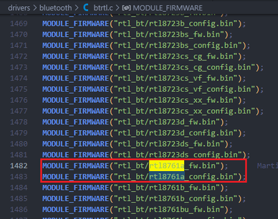

Hello I have a project targeting i.MMX8 and am using yocto to generate a Linux distro. We are connecting to a Realtek RT8761BTV_DS chip via UART2 for HCI.
Our project seemed to have bluetooth enabled by default, so I believe (probably wrongly) that all I needed to do was add a devicetree entry for uart2, which would associate it with bluetooth:
&uart2 {
pinctrl-names = "default";
pinctrl-0 = <&pinctrl_uart2>;
status = "okay";
bluetooth {
compatible = "realtek,rtl8761a-bt";
max-speed = <115200>;
However, after build+flash+startup nothing seems ot happen with bluetooth. I can manually start the bluetooth daemon:
systemctrl bluetooth start,
But no controllers show up in the list:
bluetoothctl list
{nothing}
I am brand new to yocto
-What am I missing in the yocto cofig?
-Can anyone point me to some relevant documentation on configuring bluetooth for yocto?
-Can anyone give me some tips on how to start debugging this?

Hi Zhiming, thanks for your reply, I was able to resolve this issue (of the uart2 port not showing up under /dev) by removing this:
&uart2 {
bluetooth {
compatible = "realtek,rtl8761b-bt";
After I removed this statement, the uart2 port again appeard under /dev (/dev/ttymxc1)

Hi @sgordon777
You can check the kernel log about firmware load messages.

I am trying to do this mostly through guesswork and wasting an ridiculous amount of time on it, I am not very fammiliar with Linux or it's internals.
The changes below had this working for a while but it stopped and I've not been able to firgure out why.
Is there any documentation or information which could help me with this task?
We are interfacing the rtk8761btv chip via UART2, which is /dev/ttymxc1
1- Recipe to build realtek's rtk-hciattach utility.
2- Recipe to transfer to firmware files use by #1
3- devicetree:
# dts file
&uart2 {
bluetooth {
#dtsi file
/* Panel Communicationi or Debug */
&uart2 {
assigned-clocks = <&clk IMX8MM_CLK_UART2>;
assigned-clock-parents = <&clk IMX8MM_SYS_PLL1_80M>;
fsl,uart-has-rtscts;
status = "okay";
#defconfig file
CONFIG_BT_HCIUART=m
CONFIG_BT_HCIUART_RTL=y
#project file
IMAGE_INSTALL:append = " bluez5"
IMAGE_INSTALL:append = " rtk-hciattach"
IMAGE_INSTALL:append = " rtlbt-firmware"
2,054件の閲覧回数

Can you provide kernel log with dmesg?
