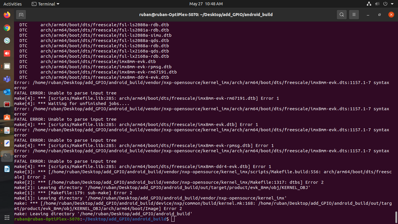

Adding GPIO in device tree error for imx8m mini evk board.
i added
&iomuxc {
pinctrl-names = "default";
pinctrl-0 = <&pinctrl_hog_1>;
imx8mm-evk {
pinctrl_hog_1: hoggrp-1 {
fsl,pins = <
MX8MM_IOMUXC_GPIO1_IO08_GPIO1_IO8 0x19
MX8MM_IOMUXC_SAI5_RXD3_GPIO3_IO24 0x41
pinctrl_csi_pwn: csi_pwn_grp {
fsl,pins = <
MX8MM_IOMUXC_GPIO1_IO07_GPIO1_IO7 0x19
in path arch/arm64/boot/dts/freescale//imx8mm-evk.dts
Error created while building is attached below
The screenshot of added and  screenshot where  the error is showing
Thanks in advance
Ruban

Please try to remove "imx8mm-evk {" in your dts file.
For your reference:
https://source.codeaurora.org/external/imx/linux-imx/tree/arch/arm64/boot/dts/freescale/imx8dxl-evk....
&iomuxc {
	pinctrl-0 = <&pinctrl_hog>;
		pinctrl_hog: hoggrp {
			fsl,pins = <
				IMX8DXL_COMP_CTL_GPIO_1V8_3V3_GPIORHB_PAD	0x000514a0
				IMX8DXL_COMP_CTL_GPIO_1V8_3V3_GPIORHK_PAD	0x000014a0
				IMX8DXL_SPI3_CS0_ADMA_ACM_MCLK_OUT1		0x0600004c
				IMX8DXL_SNVS_TAMPER_OUT1_LSIO_GPIO2_IO05_IN	0x0600004c
		pinctrl_usbotg1: otg1 {
			fsl,pins = <
				IMX8DXL_USB_SS3_TC0_CONN_USB_OTG1_PWR		0x00000021
