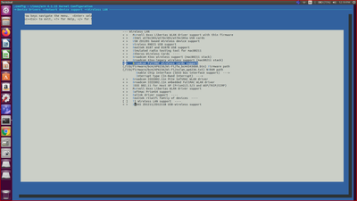

(ii) Also I have run the menuconfig tool on the bitbake environment:
bitbake linux-imx -c menuconfig
Enabled the necessary options like below image..
