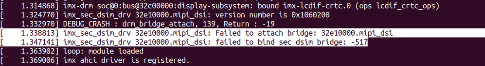

I tried to add a new panel in i.MX8M Mini with ST7701 controller on Yocto kernel 5.4.47. I got error "imx_sec_dsim_drv 32e10000.mipi_dsi: Failed to attach bridge: 32e10000.mipi_dsi"
After that probe completed successfully with sending init sequence. I can also confirm fbset on board, but can not see anything on display.

Thanks for your reply. My problem is already solved.
I follow the link bellow and replace driver with @fangkai 's   driver.
https://community.nxp.com/t5/i-MX-Processors/how-to-add-a-new-panel-with-imx8mm-evk-I-got-some-probl...
With above link and minor changes, My LCD panel worked.
