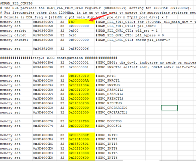

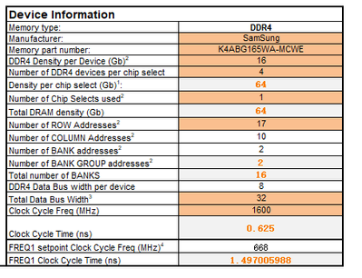

I have a self-made imx8mp motherboard, the model using DDR4 is: K4ABG165WA-MCWE, the single chip capacity is 32Gb, the main frequency is 3200Mhz, my motherboard uses two chips, but the configuration cannot be completed using MX8M_Plus_DDR4_RPA_v9.xlsx

when the clock cycle freq is setting 3200,the ddr stress test file :
In summary, this tool cannot complete the configuration of Samsung K4ABG165WA MCWE in IMX8MP (DDR, non lpddr)

xjy198903
According to the chip manual, I changed the configuration strategy, RSA can meet my needs:

xjy198903
the "DDR4 Density per Device (Gb)" can not input 32
