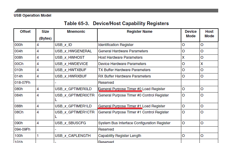

According to the i.MX6Q reference manual, there is a general purpose timer in the USB module.
So I want to make sure the relationship between SOF(125us) and this timer(1~1677215us).
Those two are completely synchronized?
For example, if I programmed the timer duration as 1000us, the interrupt will constantly generate each 8 micro frames(8x125us)?
Can anybody help me?
Thanks.

Dear Victor,
Thank you for replying.
EPIT you mentioned is one of the candidates to realize what I want to do.
But I've been searching for the simplest way.
For me, internal timer in the USB module is more attractive.
Does anyone know clock source of this timer?

I'd be happy if someone could clarify the usage of this general purpose timer which I believed to synchronize to SOF.

I think you refer to GPT however I asked about not GPT but USB_x_GPTIMER0/1. Please see attached.
If you know something, please let me know. I need your help.
Thanks.
