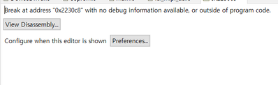

The error has changed.
break at address "0x2230c8"
Error when debugging in MCUXpresso IDE.

jingpan
Hi @sukyeong ,
The picture shows M7 core stay at ROM code but not your application code. Please check

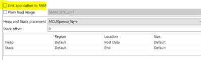

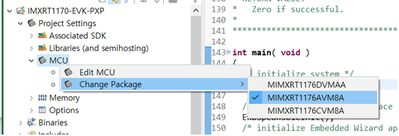

3. RT1176AVM8A is 800M device, not 1G, have you decrease the clock frequency?
4. If the project is SRAM base, can it step into debug mode?

3. Can I tell where to lower the frequency clock?

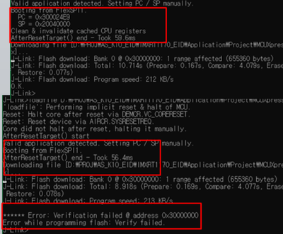

sukyeong
Hi, @jingpan
When I tried using J-TAG Commander, I noticed a difference.
I use core : MIMXRT1176XXXA_M7, JTAG mode, speed= 400k.
1. when using the mimxrt1176DVMAA, the PC and SP addresses were read by FlexSPI1.
2. The address was not read by the mimxrt1176AVM8A.
The current flash driver is MIMXRT1170_SFDP_QSPI.cfx, do I need to fix it?

jingpan
Hi @sukyeong ,
This flash driver also can be used on mimxrt1176AVM8A. Do you change the flash? If not, you needn't use other driver.

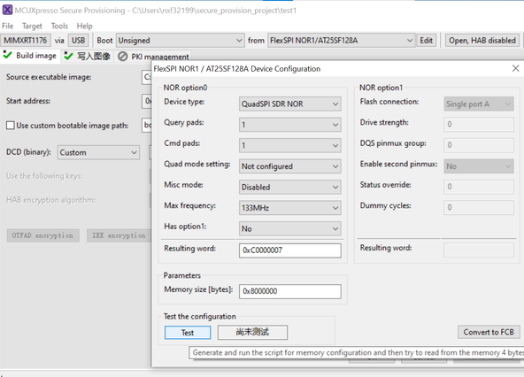

But I still concern about the flash downloading. Please try to use Secure Provsioning Tool or MCUBootUtility to connect the flash and download code to flash.
Jing

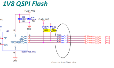

I'm also suspicious of flash..
It is currently configured to be loaded only with jtag.
Custom board is no uart or usb line, so it is impossible to connect using the tool..
Is there any other way?

sukyeong
hi, @jingpan
After removing the resistor below the problem was resolved
Thank you for your help
