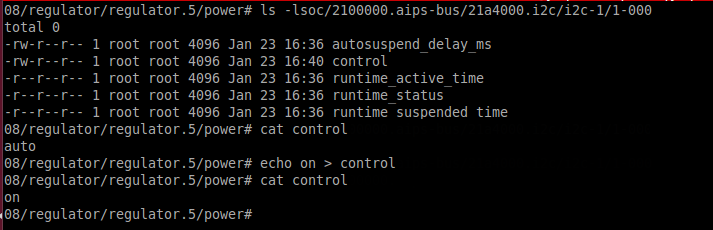

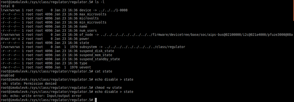

I think that I have the same problem... I posted here: pmic-user-space I do not know how I can change the state of the regulators once they have been started. As you can see in the next picture, I have only read permission, the all path was:
""/sys/devices/platform/soc/2100000.aips-bus/21a4000.i2c/i2c-1/1-0008/regulator/regulator.5""
As ypu can see in the picture, I cannot change the state for example.
Any idea??
Thanks for your time,
Javier

Have you tried with echo command
echo <value> > /sys/devices/platform/soc/2100000.aips-bus/21a4000.i2c/i2c-1/1-0008/regulator/regulator.5/*
8,345 Views

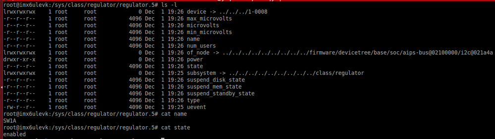

pastrana
Yes, I am. Firstly I have tried to use "cat" in order to see the values, in the next picture you can see:
Regarding the "echo", I can do it for example in:
"/sys/devices/platform/soc/2100000.aips-bus/21a4000.i2c/i2c-1/1-0008/regulator/regulator.5/power/control/"
By default it is in "auto" mode, but I can change it to "on" mode. As you can see in the next picture:
I saw in this documentation ABI/testing which "commands" we can use, the problem is that I do not have all of the files that are defined there. For example, I cannot manage the state, you can see it in the next picture:
Thanks a lot,
Javier

Hi Javier,
It looks strange. Before proceeding further can you just perform a small task.
Try to change the state of any other regulator(As I can see there are about 6 regulator in your dts file). And if you are not able to change the state of any of them(out of 6); then just comment  "regulator-always-on"  in one of the regulator setting (Assuming it is stopping to change the state of regulator), then give one more try.
KEEP YOUR FINGERS CROSSED :smileyhappy:

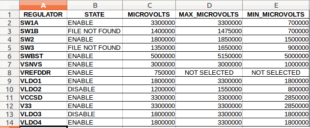

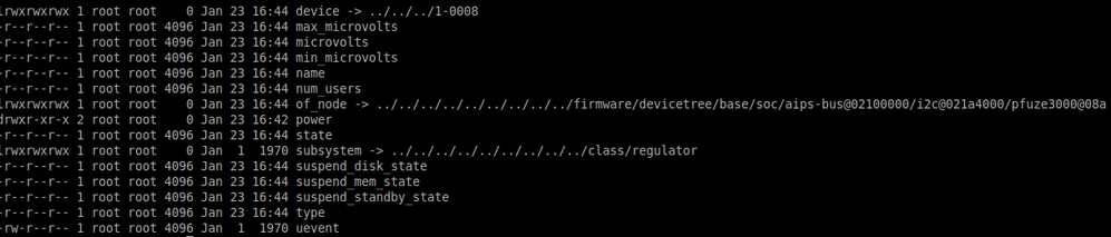

pastrana
Hi Vinod,
Thanks a lot for your answer! But I did not achieve it.. I saw you the results.
I cannot change the status of any regulator, I tried different configurations, but it could not be possible.
This is the Device Tree of my PFUCE that I was working:

The results that I achieved are:
The results of SW1B and SW3 attract my attention, because I did not found the "state" file in order to check their state. Maybe this problem is related with the other.
I am checking all this information in the path "/sys/class/regulator/regular.*/
I do not know how I have to continue... Any idea?
Thanks again for your support,
Javier
