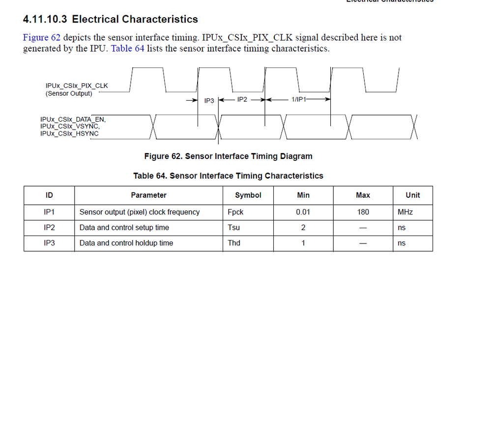

Dear community.
Our customer has question below.
About  to the input timing of the camera signal of i.MX6Solo, so  should the data be settled at the IP 2 (setup time)?
Or does the data need to be settled before IP
Thank you ,
Best.
takashi.

Hi Takashi
yes this is correct understanding
igor
