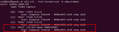

The development board I am using is imx8mp, and the SDK version is 6.1.22+g66e442bc7fdc.
I switched the device tree to imx8mp evk dual os08a20. dtb
When I don't do anything, that is to let the system automatically mount. ko ,can generate this data format

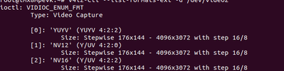

But when I want to load ko myself
root@imx8mpevk:~# insmod vvcam-dwe.ko
root@imx8mpevk:~# insmod vvcam-isp.ko
root@imx8mpevk:~# insmod imx8-media-dev.ko
root@imx8mpevk:~# insmod os08a20.ko
root@imx8mpevk:~# insmod vvcam-video.ko
 There can only be these three
May I ask if there is any operation I missed

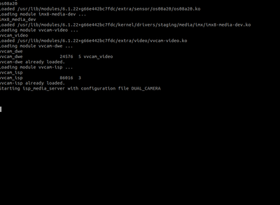

It's blocking here

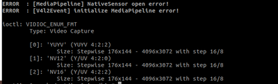

lei11
I executed the command, but only printed this one
1,908 Views
joanxie
give me full log for the ./isp_media_server CAMERA0 & to start ISP , I found you have many error on it, and for ISP document, you can find them from nxp official website, we have been released many documents for this, for os08a20, you can refer to the document
