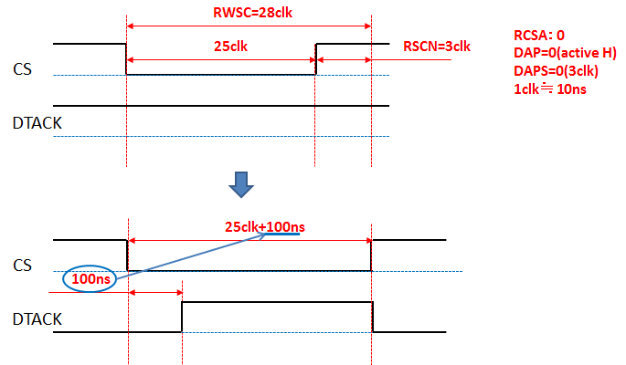

We have a question about the CS assertion period with the DTACK mode for EIM.
We use i.MX6Solo.
We set EIM as follows.
RWSC=28clk / RCSA=0clk / RSCN=3clk / DAP=0(Active H) / DAPS=0(3clk)
1clk=10ns
When DTACK signal becomes active after CS was asserted, CS assertion time is extended for waiting time of DTACK.
Is this behavior right?

as for "CS assertion period is extended for DTACK wait period" :
This is the correct operation for EIM bus
Yuri.

  CS assertion / negation timings are configured via the RCSA and RSCN bit fields ;
it is not affected by DTACK options.

Dear Yuri-san,
Thank you for your support.
"CS assertion / negation timings are configured via the RCSA and RSCN bit fields ;
it is not affected by DTACK options."
I understood that CS assertion period should be 25clk regardless of DTACK wait time.
However, The CS assertion period becomes "25clk+DTACK wait time", not 25clk.
I do not understand the reason why CS assertion period is extended.
Would you tell me the register field which we should confirm?
May I have advice?
Yuuki

is it possible to look at waveforms of both "25clk+DTACK wait time", and  "25clk" configuration ?

We cannot send an actual wave form to you immediately.
We want to know whether the following is right operation as a design.
"CS assertion period is extended for DTACK wait period."

I do not see explict mentions about "CS assertion period is extended for
DTACK wait period". Let me forward it to the team
Yuri.
