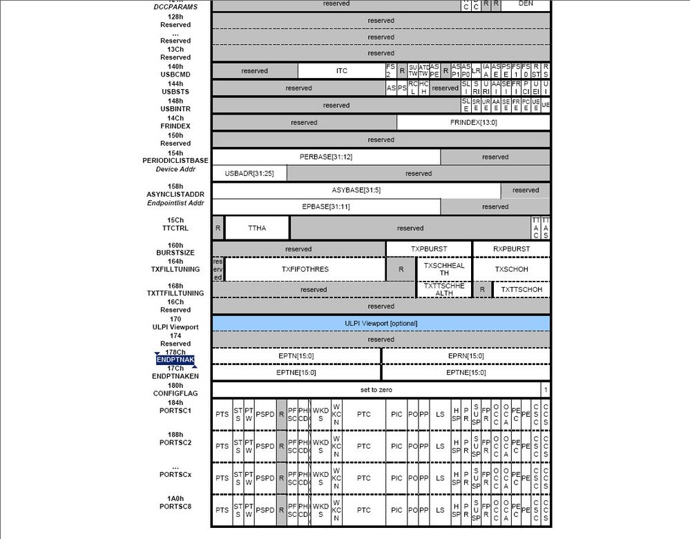

Dear  All,
In FSL WindowsBSP,
We have the problem that a CPU may be hung-up, when a register is written by USB Driver.
When a USB driver writes any value into offset 0x017C of HS-USB register, this problem may occur.
In the source code of WinCE BSP, this register is defined as ENDPTNAKEN.
However, in a reference manual, this 0x017C register is "reserved".
MCIMX51 Multimedia Applications Processor Reference Manual Rev. 1 2/2010
- Table 60-28. HS-USB Register Summary(P.2882)
In Linux BSP source code, this 0x017C register is not defined.
In WinCE,
What kind of function does this 0x017C register have?
Is access(writing) to this 0x017C register required?

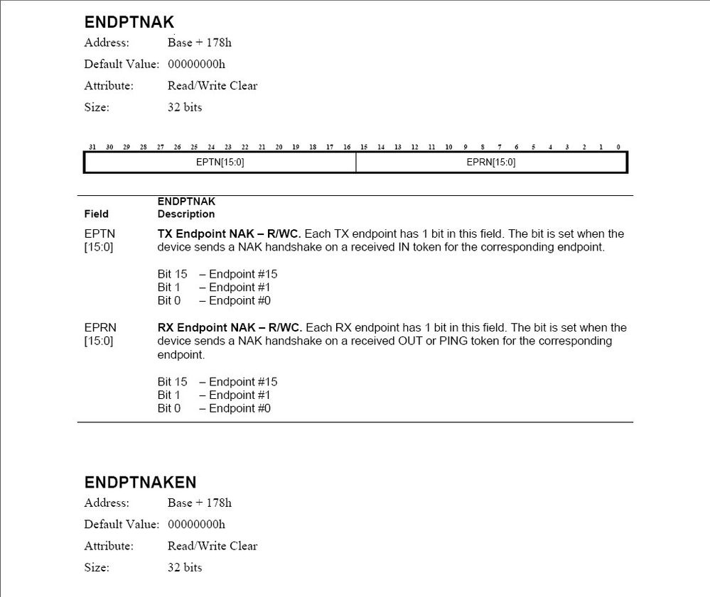

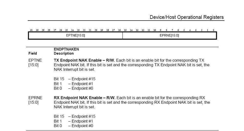

igorpadykov
Hi yuuki
please look below for description,
I think its usage is optional
igor

2,793 次查看
igorpadykov
Hi yuuki
access to this register is performed in
..COMMON_FSL_V2/USBD/COMMON/pdd.c
do you mean that this piece of code is not working ?
Also this register is defined in i.MX53 RM IMX53RM
sect.77.6.30 Endpoint Nake Enable (USB_UOG_ENDPTNAKEN)
igor
