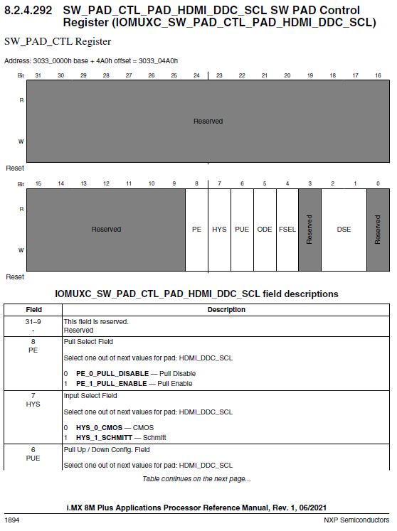

On the other hand, the register definition in the [i.MX 8M Plus Applications Processor Reference Manual]
is as follows.
0x01c3 = 0001 1100 0011
It looks like the Reserved bit[0] is set to 1. What is the meaning of this?
Or, Is the register definition I'm referring to incorrect?

  real configuration of the pin is as following:
root@imx8mpevk:/unit_tests# ./memtool -32 0x303304a0 1
E
Reading 0x1 count starting at address 0x303304A0
0x303304A0: 000001C2
  The reserved bit is not used.
Yuri.
MX8MP_IOMUXC_HDMI_DDC_SCL__HDMIMIX_HDMI_SCL bit0 is set as 1.
Why is bit0 set in DTS?
If it is not set to the reserved bit, does it mean something else?
Thanks!

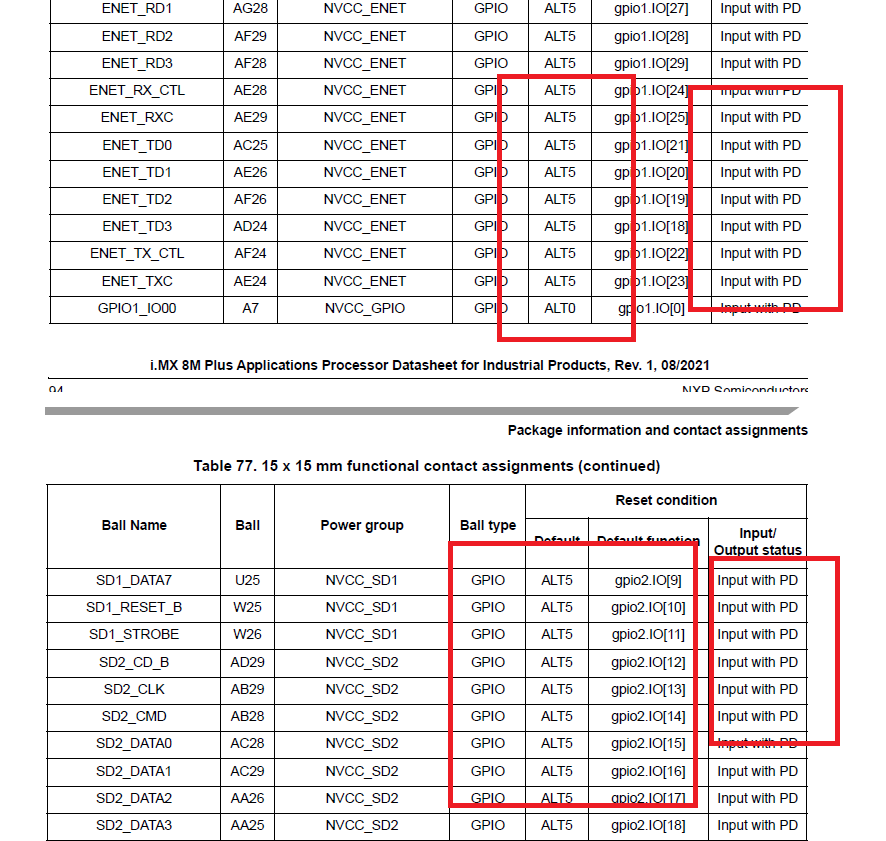

It is the information about chip default pad mux and pad ctl in datasheet you want to know?
