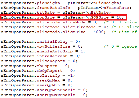

   I refer to "took imx - test - 5.3" code, for video coding.Before calling a function, I value assigned to EncOpenParam the following figure:

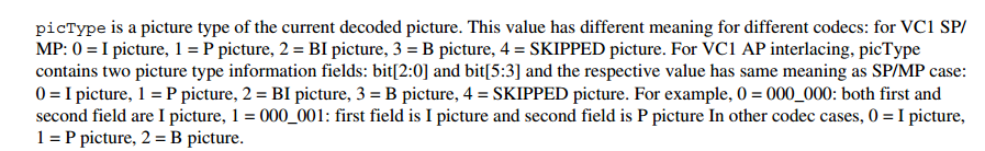

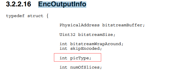

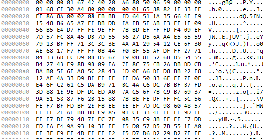

The gopSize value set to 10, usually the H264 frame structure should be IPPPPPPPPP, but I found the video encoding only at the start of the first frame of the data for the I frame.I call a vpu_EncGetOutputInfo after vpu_EncStartOneFrame encoding a frame data access code data, when sEncOutInfo. PicType = 0, or P frame.

你好,I帧的数量是自己控制的,在编码结束后出数据流出的结构体中有相应的标志位,比如你需要一个I帧,后面紧跟9个P帧,这个时候可以每10帧改变这个标志位,就可以了,我是这样做的,希望能帮到你。
